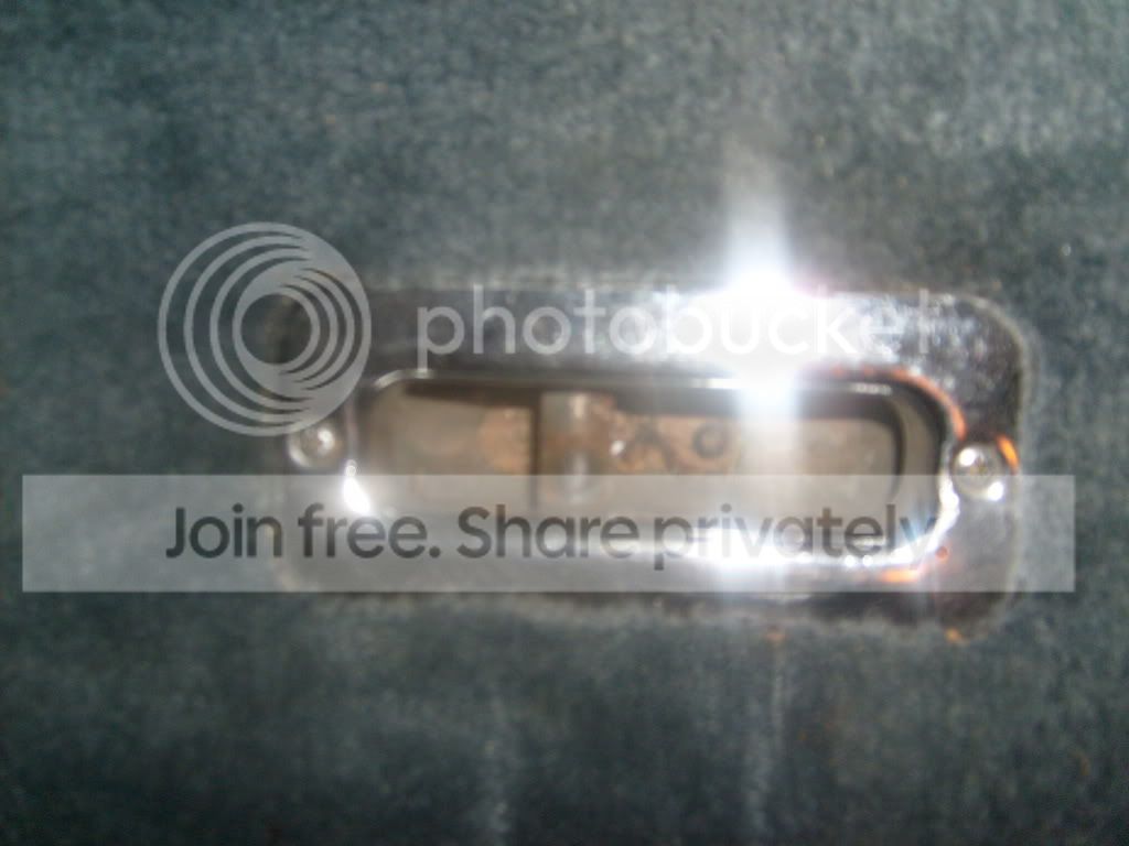

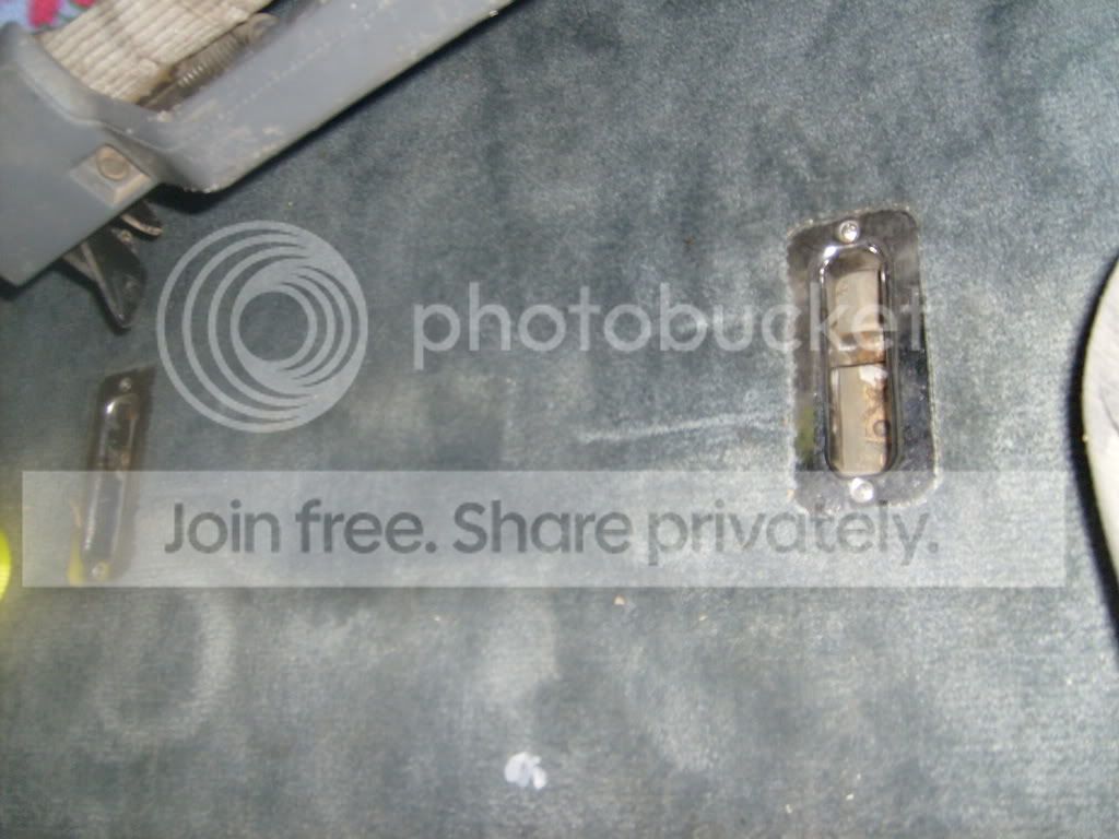

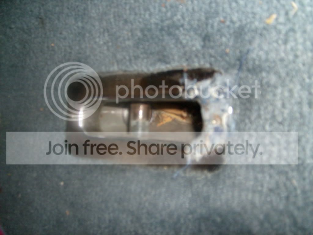

Here ya go bud:
Rear brackets:
Rear Bracket Close up:
Front Bracket close-up:
If you need any other angles or specs let me know. BTW, these are from a third seat of a burb, but I was told they were the same when I was looking to buy my third seat. Good luck. Let us know how it turns out.
