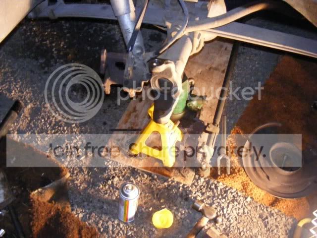

housing with knuckle stripped.. I got the idea for the wood under the jackstand from someone here. Worked so much better than having the stand sitting in the dirt and gravel.

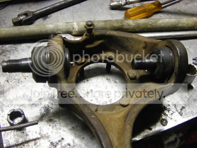

joints installed in the passenger knuckle

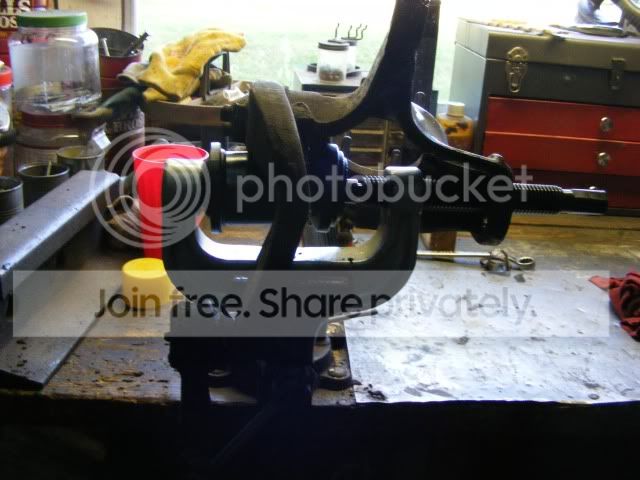

harbor freight press rigged up

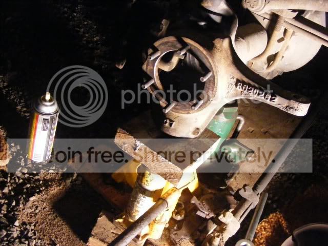

loading up the ball joints so they can be torqued

The harbor press tool worked pretty good.. especially for $32.99. I'm sure a professional tool would be easier to use, but on a limited budget this worked great. It still fit in the case when I was done too ;) I had to use a 4 foot cheater to get the lower joint to pop out too.

Hmm, I don't remember having to load up the lower ball-joint to torque the nuts down.
Anyhoo nice job! It's good piece of mind knowing everything is fresh in the front end.
sometimes it helps to seat the ball joint so that it doesn't spin when you put the nut on. i had this problem.
I thought loading them up sucked.. without doing it they'd spin. The Haynes book said just pull up on the knuckle but I couldn't get enough upward pressure that way apparently.
How do you seat the ball joint for future reference? My Haynes manual was very sparse on info.. part of why I bought a factory service manual on Ebay(which should be here in a few days).
the exact way you did it - put a jack under the knucke and lift it up a bit with the weight of the truck on it, then tighten the nut.
