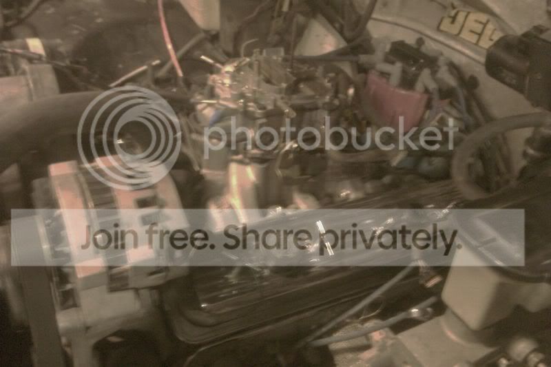

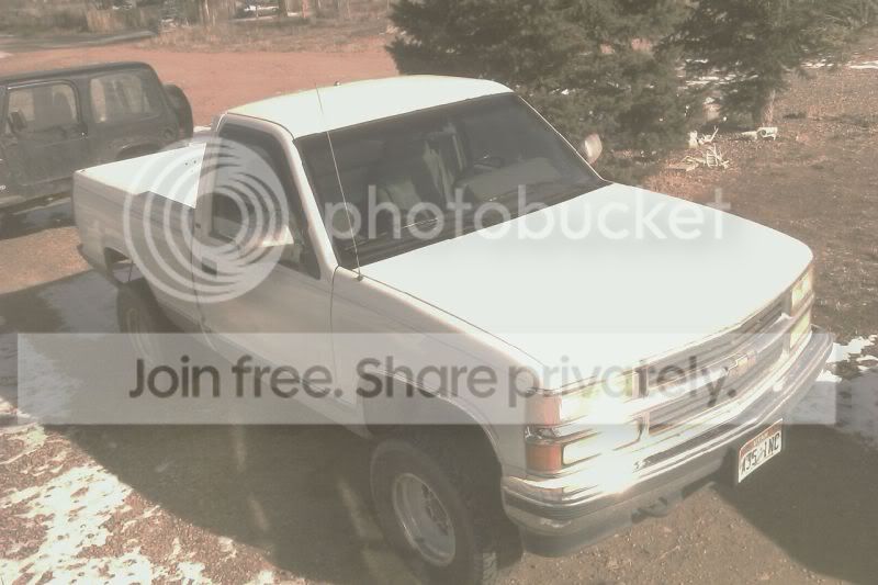

OK about the truck. It is a 1994 regular cab short bed silverado Z71. It has a 10b rear with G80, 241 x-case, built TH700R4 with all the corvette goodies, the larger 6 gear planitary, set kevlar bands, redline clutches, Blah blah blah. When I had it built I asked for the baddest 700r4 he could build for a street driven vehicle. The engine isa 350 bored .030 over flat top keith black pistons, the biggest cam I have ever run, molly and chrome and lots of other good stuff I cant think of right now. Anyway according to desktop dyno from when he built it its supposed to be around 425hp 450ftlbs.
the truck has a 2.5" front diff drop and is cranked up to level with the rear which has a AAL. Right now it is riding on 31x10.50x15 big o XT's on old gambler 15x8 wheels.

Tune it (the big cam is difficult to find a happy medium)

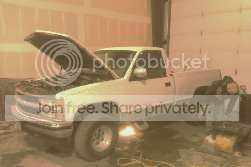

Take it to the trans shop. It has a lock up converter but something about a computer controlled servo motor needs to be swapped to a line pressure switch since I am not running a computer anymore. I will also have them set the TV cable to the propper pressure since its a performance trans.
