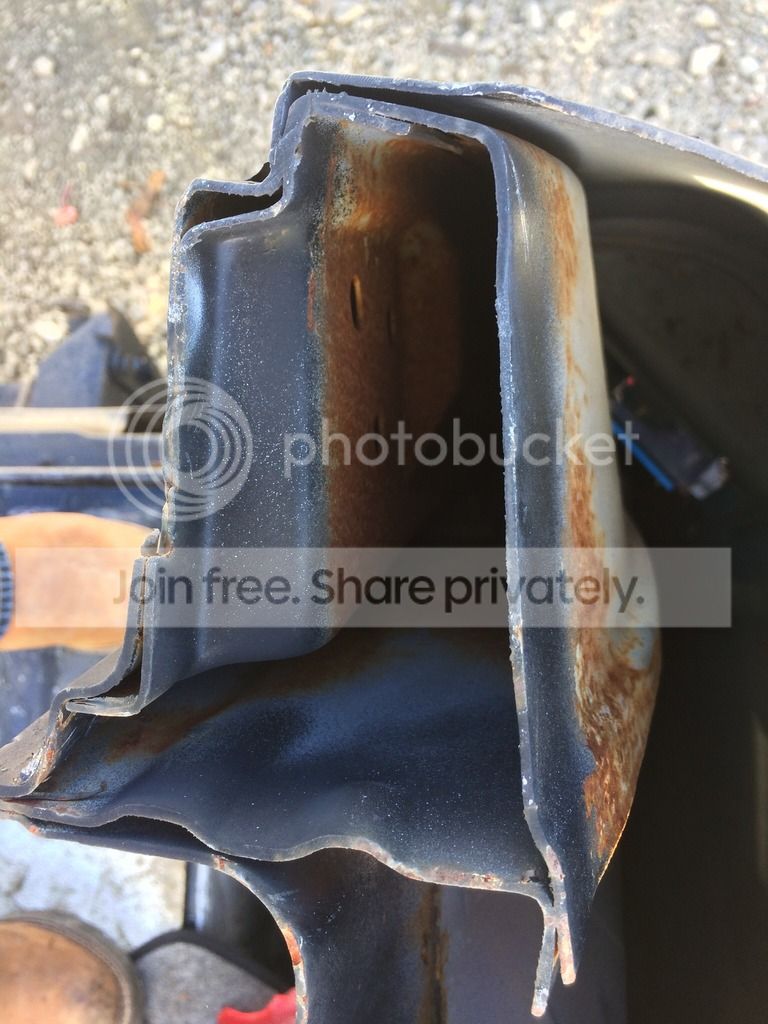

I saw a hacked tailgated 90 or 91 burb in the boneyard yesterday...they converted it to a truck. This allowed me to take some pictures so you can get a visual of the innards of the upper hinge area to see what you will be cutting into. Lower area was similar, but too hard to photograph.
Here is the driver side looking down. Note the holes for the hinge bolts. The plate needs to go here. Way down there, the 3 lower holes were visible too.
Here you can see where the tailgate striker pin was (I took it for the nice bushing still on it). See that dimple? It APPEARS that this marks the center of the three holes from above. Same appears to be true for the lower hinge. I would try to take a hole saw to the striker area to remove it and also use the new hole to slide a nut plate or nuts with thick washers up in there. Personally, I would just use an adhesive to hold a plate/washers on. I don't see a reason to weld it. Also, the cut hole is in a location that would be easy to glue/weld a plate back over it.
