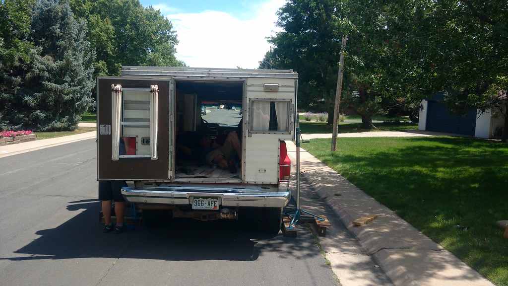

Every so often I see someone asking if barn doors can be put on a Blazer. Then I stumbled upon this pic and can honestly say that yes it can be done.
There was another on craigslist in Denver a year ago or so. Keep in mind the angle of the back of the Suburban roof is NOT the same as a Blazer. The Blazer top is more vertical at the rear and the Sub slopes forward. That one had to get some serious surgery to the fiberglass top to make those doors fit.

I feel the barn doors are more user friendly for getting stuff into or out of the back. @ZooMad75 besides the drip rail area the top does not look too modified??? Am I missing something? If someone could do this and get rid of the exposed hinges I feel it would be a huge improvement over the stock tailgate setup.

When you park a Burb and a Blazer side by side you see the difference. The one pictured above has been leaned forward to match the burb doors. Who ever did it did a good job as it looks "normal" in the photo. I did crib the pics out of that Craigslist ad from a while ago. You can see this one has the Blazer top unmodified, but the doors don't lean forward at the top. The doors are almost flat.

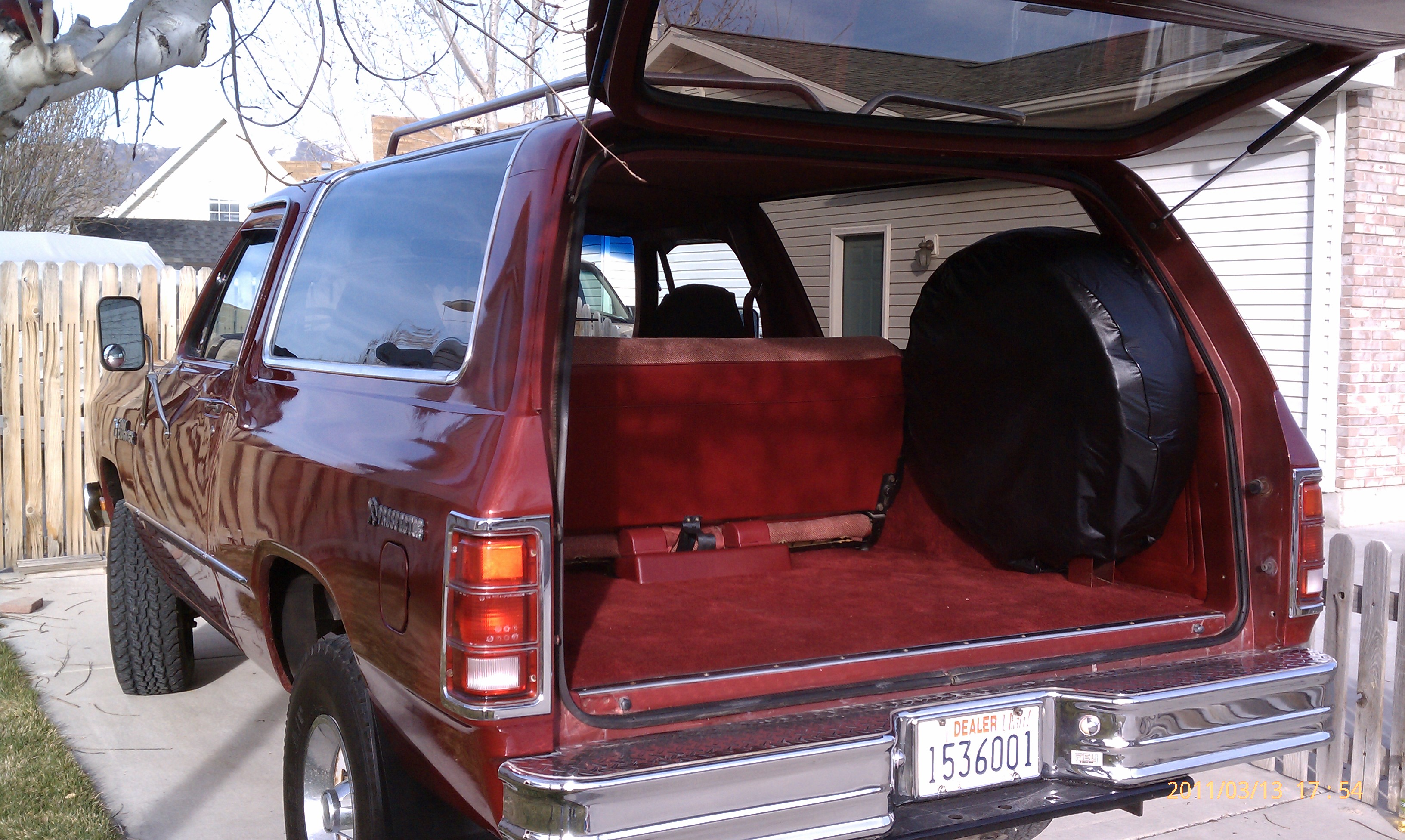

The best idea I think for a gate is what Dodge did on the later full steel roof Ramchagers. Liftgate! Way better setup. Up and out of the way, provides a little shade/cover when open and you can reach right into the back without leaning over the tailgate.
The major problem is the weight of a liftgate like that and mounting hinges into a fiberglass top.
Barn doors will have to be seriously modified in order for them to fit also. They are too tall new windows would have to be made also, the one pictured you can see the windows have been modified.

The RamCharger hatch is a pretty cool feature , but it's not a removable hardtop

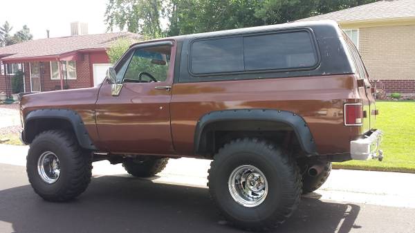

Burb gates and Blazer gates actually differ. Burb gate angles forward above the tailights and is actually taller. This is why guys wanting to put a Blazer top on a burb need to graft in the upper corner of the quarter panel to allow the gate to line up and give the top a bed rail to bolt too. It's kind of hard to see in the pic below from the angle, but you can see the burb has a constant slope from the tail light up to the roof leading forward. The Blazer quarter goes almost vertical (same as a pickup bedside) and then the fiberglass top has a slightly less forward lean to it. The quarter shape is what allows one to run a pickup gate on a Blazer without it looking funny. All the bolt holes are there on a Blazer to use a pickup gate too.
