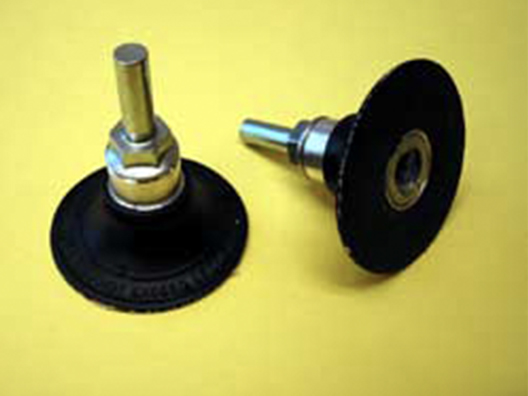

roloc?
it's a product line name from 3M... i've been using them since their introduction ages ago.. they use a arbor/disc holder in 2" or 3" like this

thats why the angle die grinder is by far the best way to use em.. it's just like a mini grinder.. perfect control... unlike an inline tool...

Right angle grinder or a surface prep tool are the way to go for rolocs. They LOVE the RPMs.

I have Snappy's surface prep tool with the built-in arbor for the rolocs.. i don't like it.. it doesn't spin up nearly as much as an angle die grinder...
