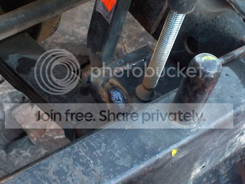

Anyway we go on a trail called true grit, I think, and I bust the front spring hanger completely off one side and half off the other side. And we only did two obsticles.:eek1:
I admit, I never finished welding them up when I was building it. But even so, some of their rigs are far beyond what I will ever be able to get this one to be.
While Marv headed back to camp for the readywelder, Fred brokeout his air grinder and prepped the areas for welding.
I cant remember who came up with the idea of trying to weld it with batteries, but Pauly supplied the welding rod, Fred had the welding goggles & grinder, and Alan added his battery to my two.
Thanks guys:bow: :bow: :bow:
While I was trying to keep from stressing out they showed me that welding trick really works. I never thought it would be strong enough to hold the leaf springs, but I'M happy to say I was wrong.:laugh:
http://i100.photobucket.com/albums/m5/fatbob2/parker/parker056.jpg
Not sure how to link to a photobucket album but here's a pic.

3 batteries and 6011 gets it done:D (BTW - Pauly, get some different rod;) ) It was a cool fix, but at the same time it wasn't a cool situation:mad: .
Try 6013 or 7013. The 60 melts easier for trail use. I carry 6013 as does most of our young gun amigos. It is an all postion easy start rod. Works well on dirty metal. Carry 1/8" and a bit of 3/16 and you will be set.
You have to realize how prepared we are before you critisize fred. We had a good miller 135, grinders, and extra steel all back at camp. Had bob's situation been known we would have fixed it up before he even left. I did finish weld the hangers before he went home too.
Bob, you still need to grind all of that weld off, clean it up, and have it re welded. It was really dirty when I was buzzing.
