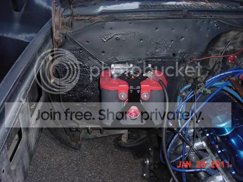

My red top is on the firewall where the factory hvac shoe box was. Keeps all the runs short.

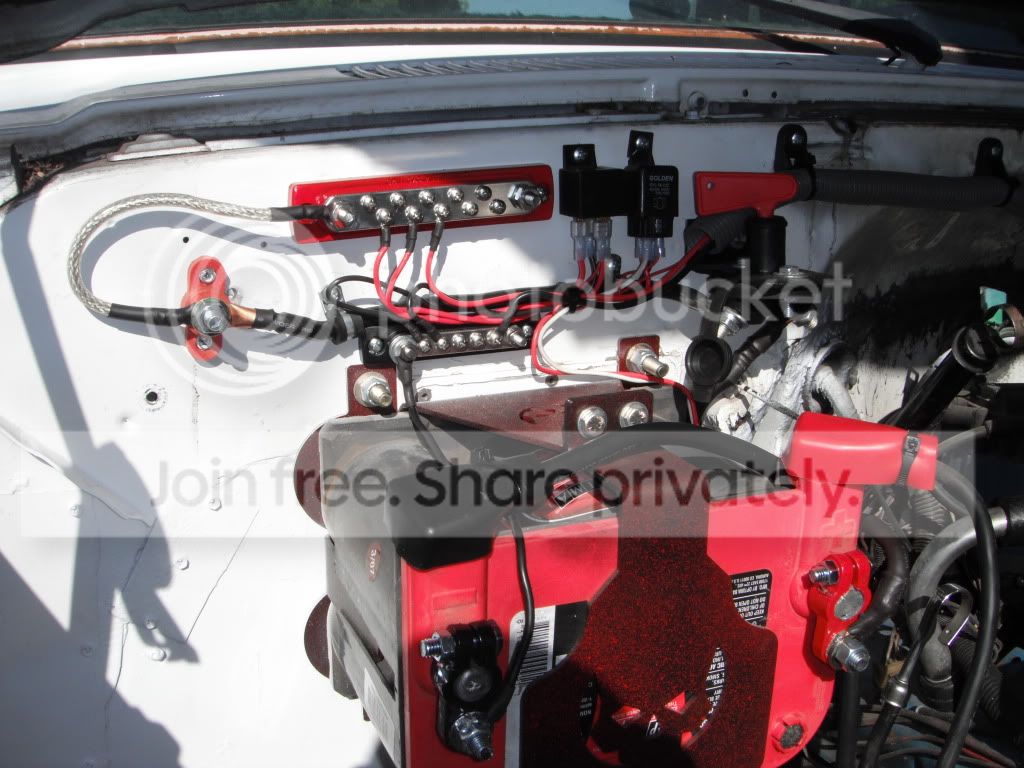

Thanks, thats just what I needed to get it running for a trip, there is a little more going on now. When I get time I'm going to move the relays inside and add a second isolated battery.
Can you post info on those clips/holders on the horizontal run above the distributor please. Nice, clean and secure.
I can't remember where I ordered those. Most of that stuff is marine electronics stuff. I ordered from a place online once then found out we had a boat store locally that carried it all so I shop there now. When I'm not posting on my phone I'll try to look back and find where I ordered them.
They're handy because they're designed to accept a zip tie.

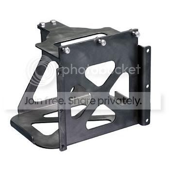

I used an Artec box -
there is my answer. did you buy that mount ?
Yeah I bought it from ballistic before they screwed over the off road community. A lot of shops make them though.
I don't have a picture handy but there was a seam on the inside of the firewall that I cut slits in and layed over so it was flat. I ran two wide pieces of flat bar on the inside so it distributed the load across the firewall better.
