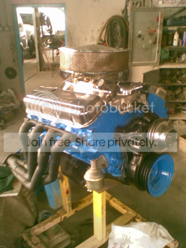

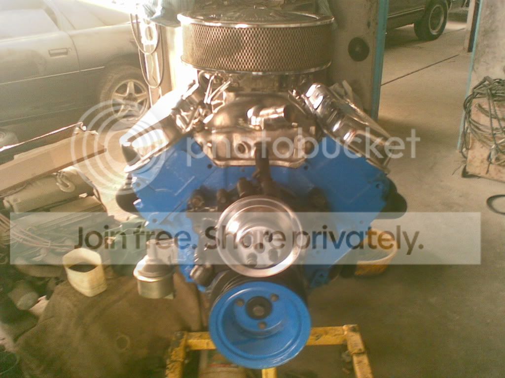

Ive got these on mine:
IMG]http://i489.photobucket.com/albums/rr252/454blazer/25062009013.jpg[/IMG]
IMG]http://i489.photobucket.com/albums/rr252/454blazer/22072009454.jpg[/IMG]
Hope this helps.
Have you had these in the truck yet? I've got headers that fit between the frame rails, but looks to be clearance issues with the front driveshaft and tranny shifter... Yours lookto be shorter than the ones I have, what are they?
