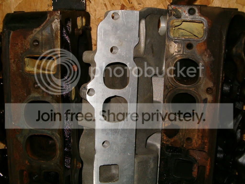

I have that same drivetrain in mine. I put that Edelbrock intake on my 781 heads (large oval port) see comparisons here:
My head guy did some extensive port matching to get it to work on the bigger heads.
ya it will hurt flow. 1/2 the charge will be hitting a wall and make a tone of turbulance.
would have to do some major gasket matchin/blending and not realy worth it. just grab a peanut port intake and 30-50 doller adaptor back to tbi .
