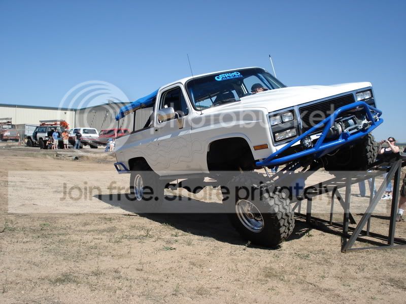

look for a ramp to go airborne with it to loosen thing up.. aha not sure what to say.. i know if its new it'll be stiff and needs to be broken in.. otherwise u got high spring rate. or shocks are stiff

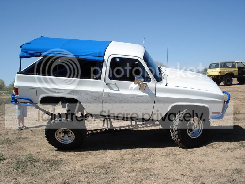

This is a local Colorado guy. 6" front BDS springs and 2" rear BDS springs with a shackle flip. I have a 4" BDS kit and both ride and flex very well.

Mine will actually go pretty far up the ramp, about like yours, and seems to flex fine doing that. It's just when you are driving it around for normal driving that it seems to be excessively harsh riding.
