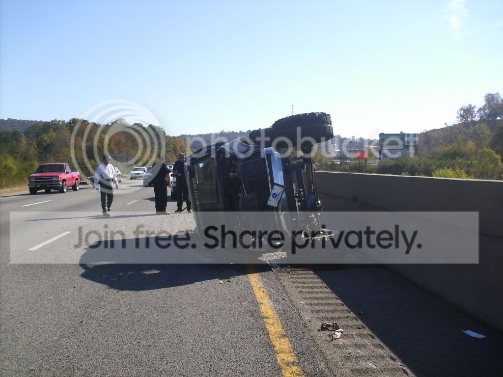

Buddy from the other coast had a close call today.
extremetahoe said:
came into what they call death valley, hundreds of wrecks in this one stretch at the bottom of a big hill, you have a little narrow bridge that a truck and semi barely squeeze by on just before it turns back i...nto a 6 lane. Well me and the semi where tight and I had to move over because he was right on top of me, well when I hit all the pot holes and uneven pavement mine went to fish tailing. I fought it for almost a mile and couldn't do anything with it so my only othe option before jack knifing it was to put it in the wall and when I did all eight tie downs snapped it almost went over the median rolled two or three times don't really know and flopped back down in the median and slide a ways. Brand new tires hubs and all. Just couldn't get it to pull out. 55 miles an hour,

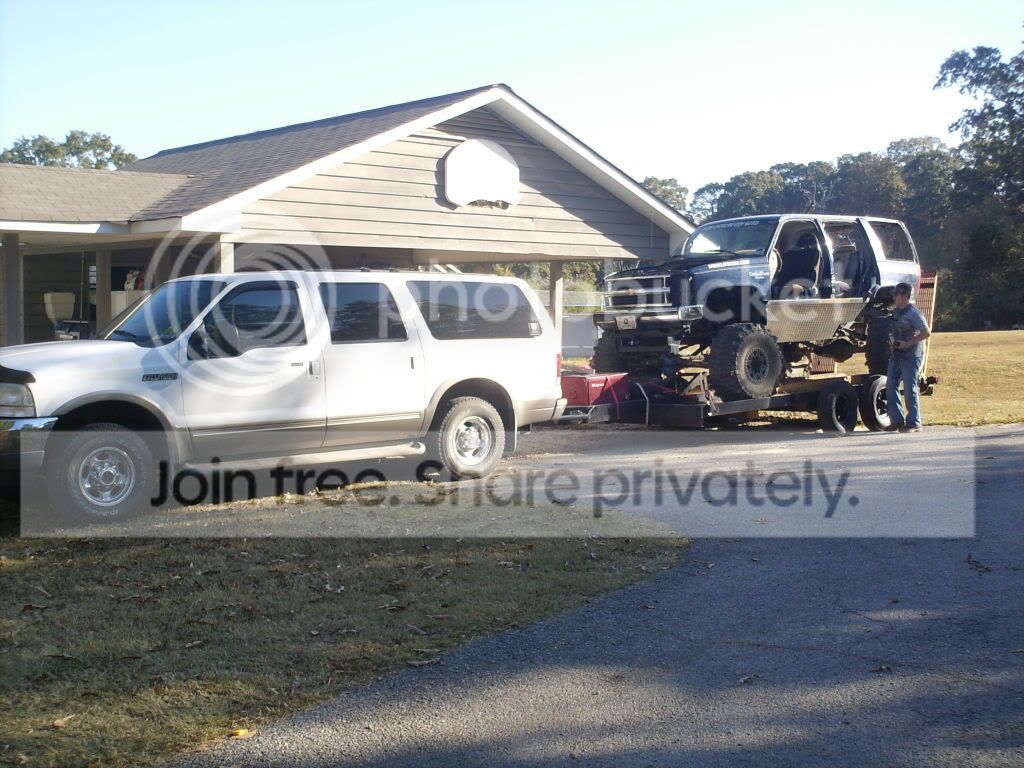

At first glance, the first picture, before the wreck, it would seem that there should have been plenty of tongue weight. Most of the truck is forward of the centerline, plus he has a big toolbox on the tongue.
But, he does not appear to have an equalizing hitch, and the wheel well heights of the front and rear of the tow vehicle seem about the same. So not much tongue weight.
Unless he has big air shocks.
Either way, he probably needs more tongue weight, plus a sway dampener if he does not want to put on brakes.

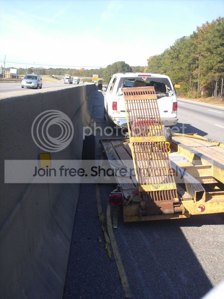

As for tie-downs, I see a chain on the trailer, but I also see lots of broken straps. Straps are a great invention, but there is still nothing like cold steel to keep something in place when it hits the fan.

and who the hell was the person who figured no trailer brakes on a trailer that heavy by its self let alone 5k-6k lbs of load on it. :whistle::doah:
by the looks of the setup in the pics it was a wounder thay made it as far as thay did. :popcorn:
He posted today that he was using 3500lbs staps.
