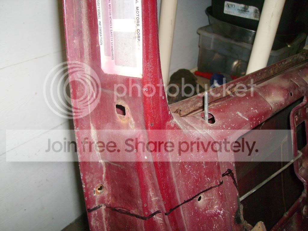

I've just disassembled a set of doors to make half doors. On these ('79) doors, the bottom of the rear track does not have a mounting point. The top mounts through a hole on the rear of the door, near the vertical center of the door. It is up high enough to meet the rubber in the window frame. I can snap pics if needed.

This is the mounting hole above the latch/lock mechanisms:

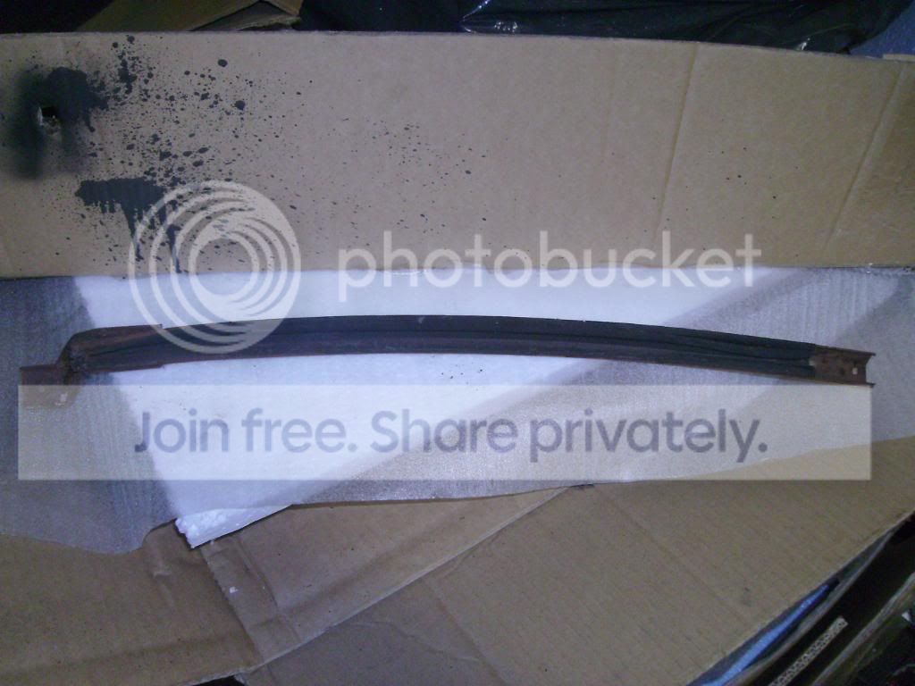

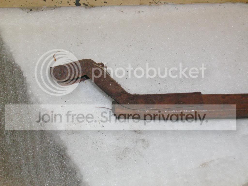

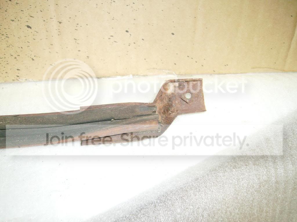

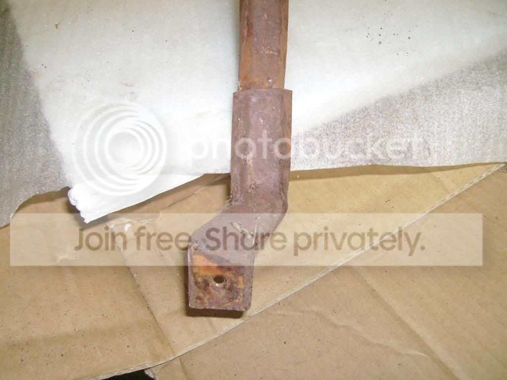

This is a driver's side rear guide/track from a bunch of different angles, specifically focusing on the mounting bracket:
well that mounting hole is higher than the top of a convert door..........
one of my guides the bracket goes up like that and the other one is different

Yeah I was right.................the brackets welded to the glass guides are different between the pickup/half-top and the full convertible.
The guide is the same but the bracket is different
I have 1 good F/C guide for the passenger side.............
I just hafta find a driver's side guide for F/C or fab a Z-shaped bracket...
