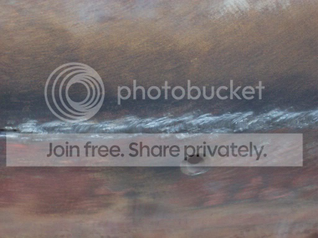

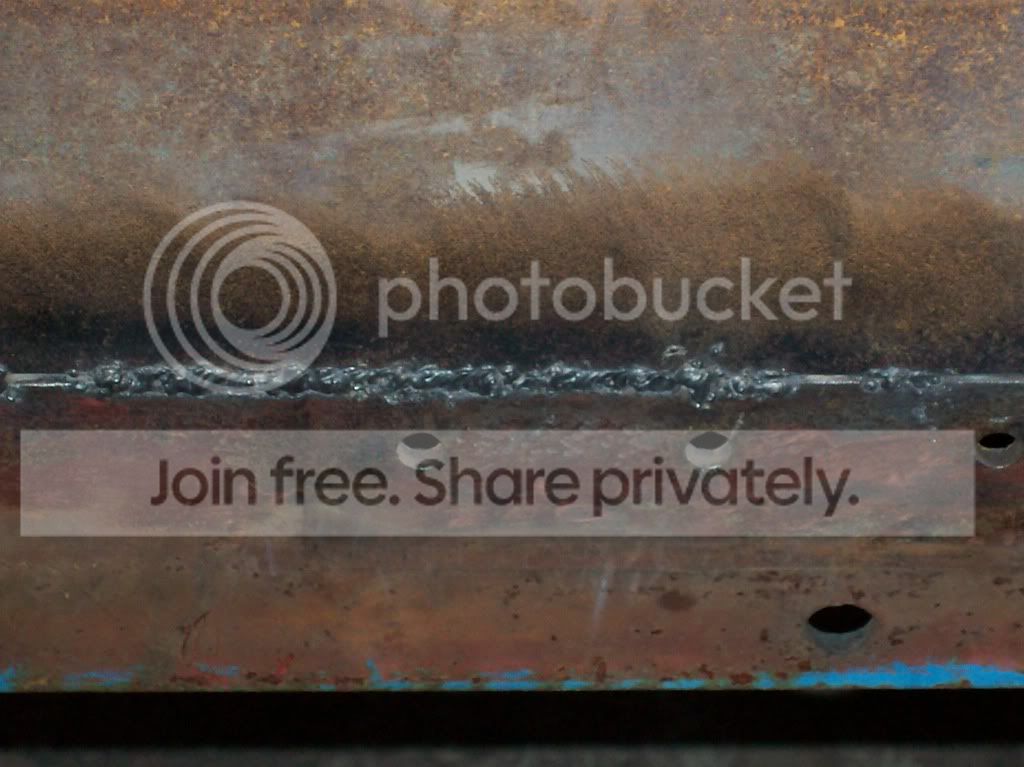

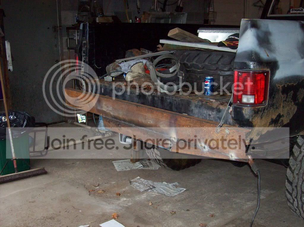

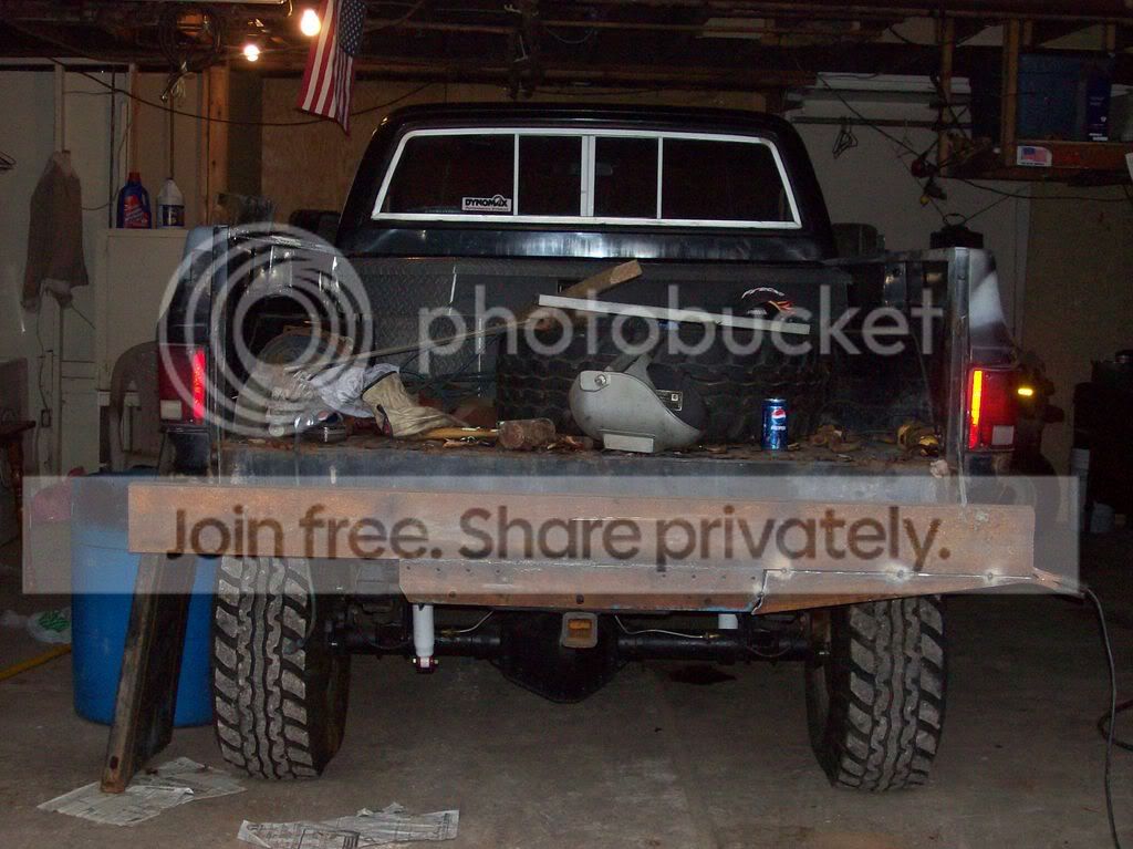

this is my first time welding, making my homemade rear bumper for now. what u guys think of my welding and hows the bumper look so far?
using a cheap habor freight welder with flux wire .030 wire.. i ran out of wire. i should have bought another roll.. which one should i buy or get same kind?.. let me know thanks.

Two observations from a slightly-less-noob welder:
Clean the surfaces to be welded. Clean them well. Hit them with a flapdisc or even a grinder wheel, so they're nice and shiny.
You gotta work on your C's... they're supposed to look like a stack of dimes. (I can't claim that mine always do, mind you =))
You aren't getting much for penetration there, I don't think, and the above should help some. A welding machine like that isn't going to burn through thick stuff, but with good clean surfaces and a steady hand, you can prolly do better.
Did you weld brackets on the back, or did you start with the small stuff?

Oh yeah, and clean the area where you put the ground clamp. I mean, would you put your battery cables on something as rusted as that? :deal:
Particularly look at the third and fourth pix I posted, you'll see great bloody swaths of grind zones there, nice and shiny.

What rods are those on the floor?? 6011's will penterate realy well but are realy messy. I think you should try turing your heat down about to reduce your splatter.You should grab some scrap metal and just practice some beads on top of the metal to get used to it and better control. The more practice you get the better you are. Try to keep your hand steady and keep a constant flow. What angle are you holding your rods at ?

looks like your trying to string your puddle out to long, slow down and let your puddle get abit larger and then start down your seam..w/each step forward let puddle burn in and try to keep puddle size more consistant...
looks a little cold to me also. mayb little hotter and little more wire speed...but like was mentioned clean metal shiny b4 starting, mayb even V the seam some... anything needing to be uber strong, i tig most of my stuff on root pass w/o any filler, just puddle together getting good penetration, then finish zipping it up with 7018 on any thing thicker than 1/4''... can make the 7018 as slick as mig, but use mig on thinner stuff..
when your welding, watch edges of puddle run in quickly w/base metal and fill in any under cut...i was always told if you mind the outer edges of your weld the center will mind itself
also if you can use solid wire w/ a gas shield, it is easier, as the biggest problem i've noticed people new to welding, is haveing trouble distingushing the molten puddle from the molten slag, w/ gas shield its all metal puddle, so you can see and control puddle alot easier...and practice,practice,practice!

Like they said, your moving to fast and you need to move in half moon shapes.
Also if you dont have a big welder (220v) then you can not weld 1/4" plate in a single pass. You will want to weld both the inside & outside seam of the metal to get decent penetration on both side. Or you can bevel the edges and do a multi-pass weld to get full penetration.
For welding heavy stuff like that your stick welder will be a much better choice.

the mig say MIG 100. the amp ill have to look, or its 100 amp? how do i weld the arc? cause everytime i do it the rod gets stuck on the metal. am i going too close or what?
Your welder is 100amp then which definitly won't do 1/4" in a single pass. Weld both sides of the bumper or bevel them. Also use good wire it helps alot. Get some Lincoln wire or something with a good name brand. HF wires is junk. Also switch to .035 Flux Core wire and .035 tips. It will burn a little hotter and help with penetration. Also make sure the metal isn't touching each other when you weld it. Having a slight gap will help increase your penetration.
My 135amp 110v Mig welder is only rated for 3/16" plate single pass and you have to have it turned way up.
Stick is about technique. If you are sticking it to the metal then you are to close. You have to learn to strike and arch and keep it at the right distance. If you learn to stick weld before you learn to mig weld mig welding is EASY.

if its a 100amp crank it up and go slow and the previous pictured photos are good examples to follow. slow and steady as it doesnt look that steady use 2 hands one to run the trigger and the other to guide the tip. and if you can well both sides and the flap wheel it smooth on the front...on back make em big and leave them be
Try taking it off and welding it on the bench. Its easyer to weld in the flat position then it is in the horizontal especialy stsarting off.
exactly what my dad told me tonight. im takin it off tomorrow. it was left on the truck for measurment, putting it together thats all. its coming off so i can clean it up, paint it. well
