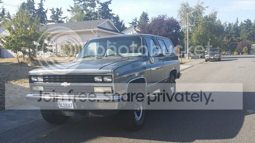

I bet if you would put some stock wheels on it, it would behave better.

I agree with this completely! I roll my eyes at it every time I see the wheels lol
