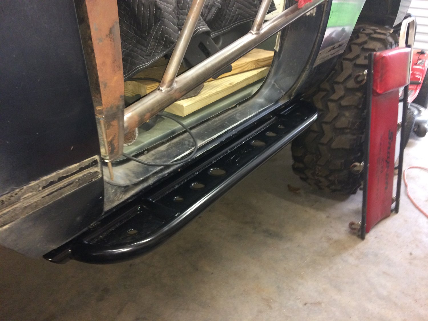

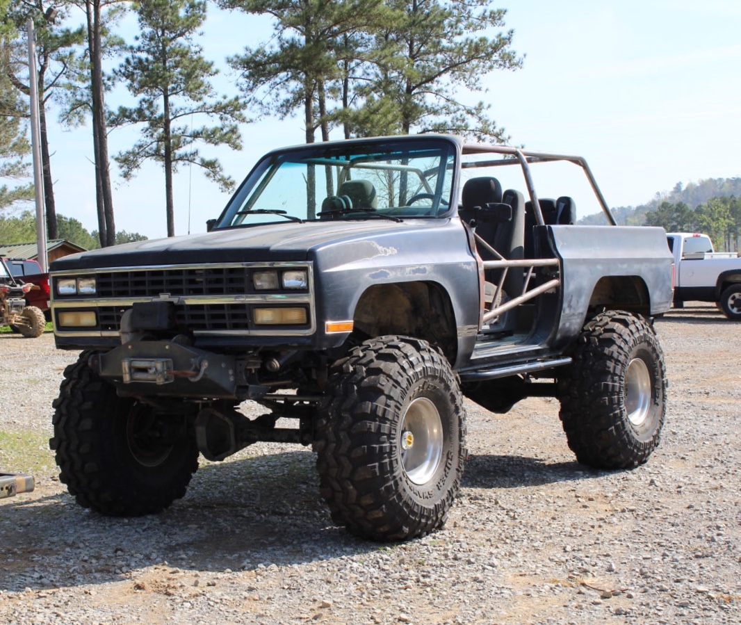

Mine are set level so they also serve as a step. I added a couple of stantion tubes with filler plates so your foot wouldn’t slip through, the plates have holes so they won’t hold water when cleaning.

Mine are level as well. 1 stantion in the middle. Plated with swoops cut on the edge of the plates for drainage. Added some grip tape to top of tube where you step so it ain’t slippery.8CE8775E-4CE8-4D3C-8F0D-B4ABDE16C482.jpeg
