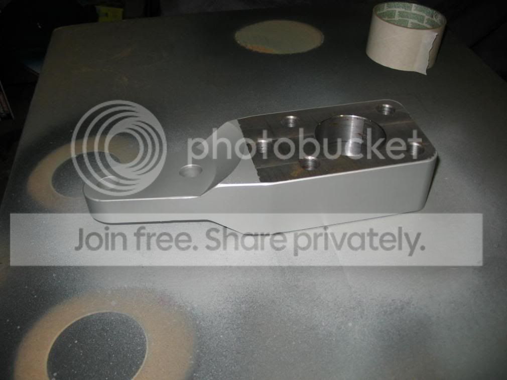

I went with Sky over ORD because I like the 1 piece arm better. I am sure it makes no difference in strength, but I like it, and they are cheaper.

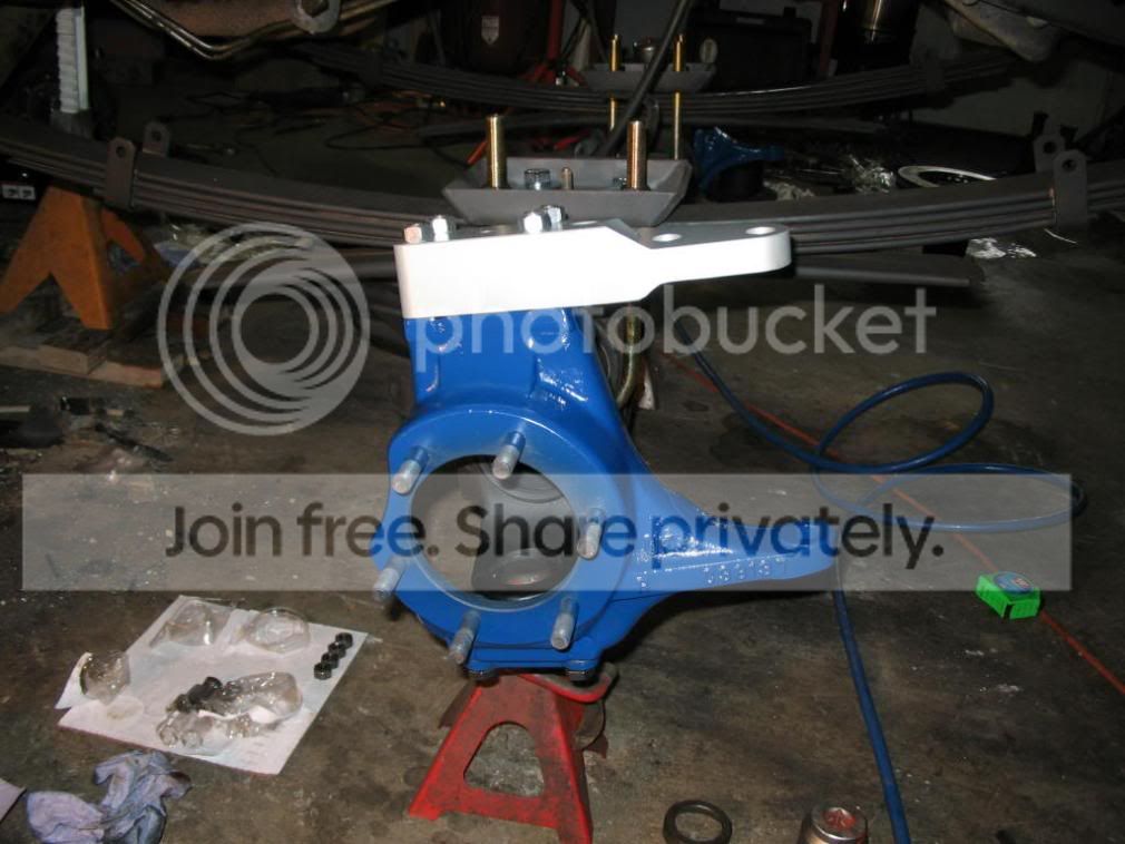

My arm
I think judging from this picture you could run highsteer with the 52's and Sky's arm. I have since added a zero rate up front so that brings the springs up some. It might be close.

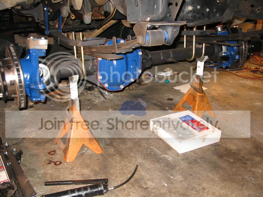

I found one with the zero rate in. Looks like there is still enough room to do high steer to me, but not sure on the spring plate issue. I imagine if they did run you would just have to take a bit of the top of the forward lip. I had to trim the rear corners on mine because my shocks were rubbing them a bit.
I have zero issues with anything making contact while flexing though..well except my tires :p:
