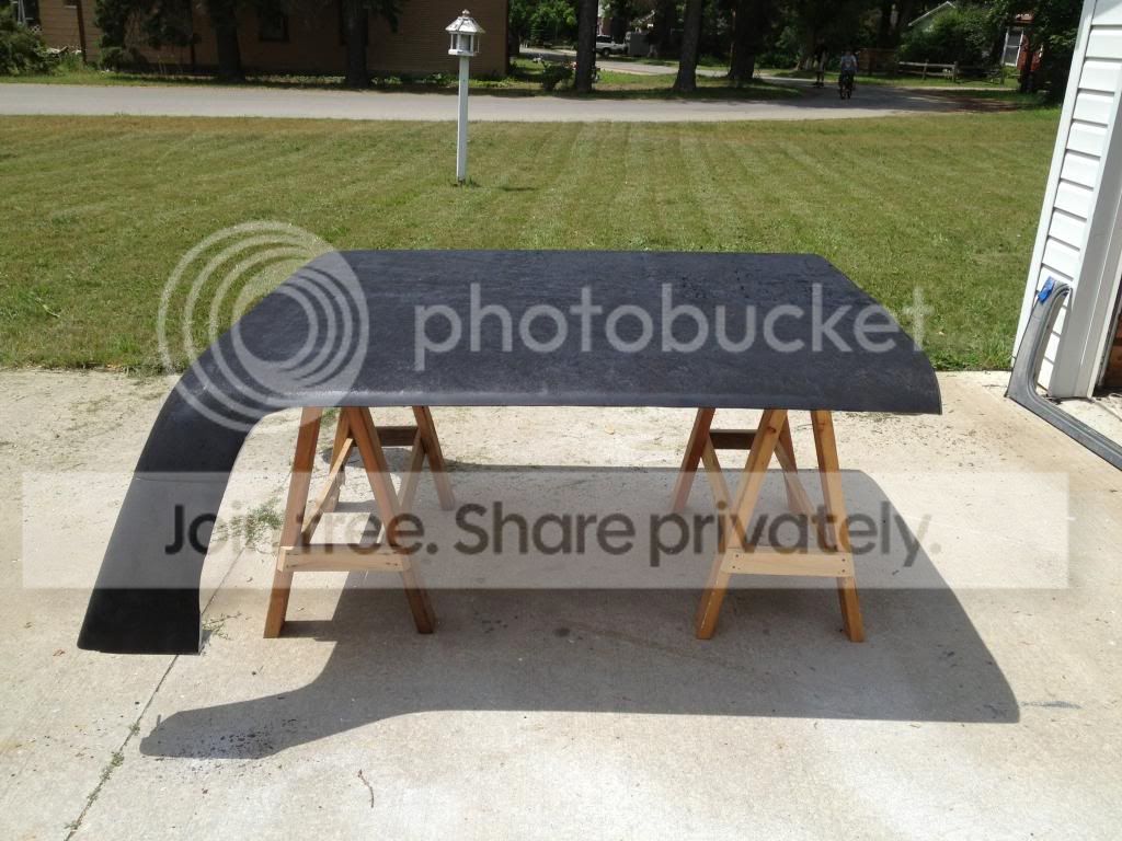

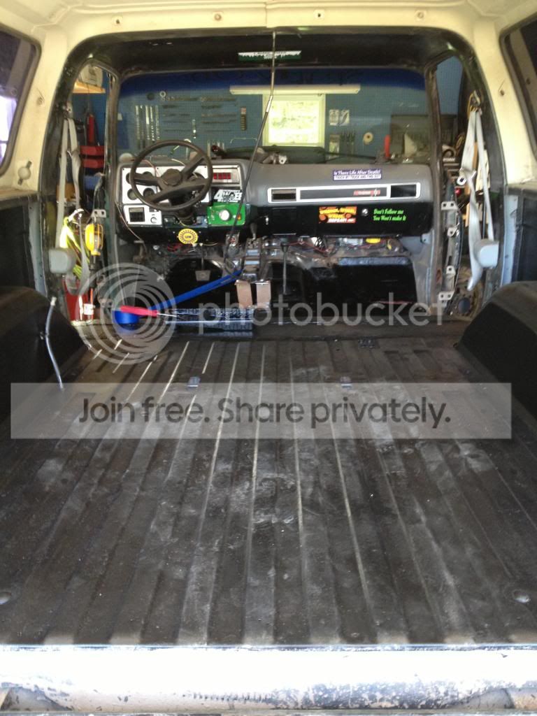

Raptor bedliner! Key is prepand talking LOTS of PREP, did a post with pictures to show what finished product looks like on the inside.
