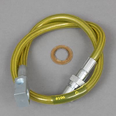

I'm curious what people are getting. I have 5-6" lift and a pretty flexy suspension. My current brake lines are about 24" long and they looks like they will limit droop. The ORD ones look good, but a little pricey. I was going to go for their 29" ones, then when I saw $18 for shipping I had to pause. Superlift makes some fancy looking ones, but I can't tell how long they are. They act like telling me how much lift they go with is enough information. :rolleyes:
Not sure about the Superlift lines, but the ORD ones have a teflon tube at the core, then a layer of Kevlar braid, then a the stainless braid, and then the protective outer vinyl cover. I'd make sure you are comparing apples to apples with the features before worrying too much about the price.
I ordered the line 25" front line and 18" rear line from ORD for my 78 K5 with 4" lift. The only problem that was run into was the front line was a bit long and I had to have a bracket fabricated to my front U-bolts to prevent the slack of the line from rubbing against my tires.
Yeah, I ended up ordering their 29" ones. I couldn't find anything else ready made that seemed as good.
As far as keeping it out of the tire, it looks like a lot of people find a way to mount the line loosely to the shock. I'll be researching that shortly, since the 29" ones will have a lot of slack at ride height.
My ORD ones are holding up well on both my trucks. My trail rig used to have Pro Comp stainless lines (what ORD used to sell) and I accidently dropped the caliper once and it ripped the fitting off the line :doah: Also, if you have a local hydraulic hose manufacturer, they could make you brake lines in any length you want
I twisted the ORD ones so they naturally pull away from the tire. Doesn't seem like any extra tie-back is need. I might do something anyway though.
