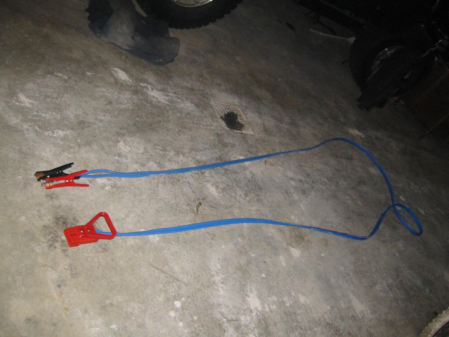

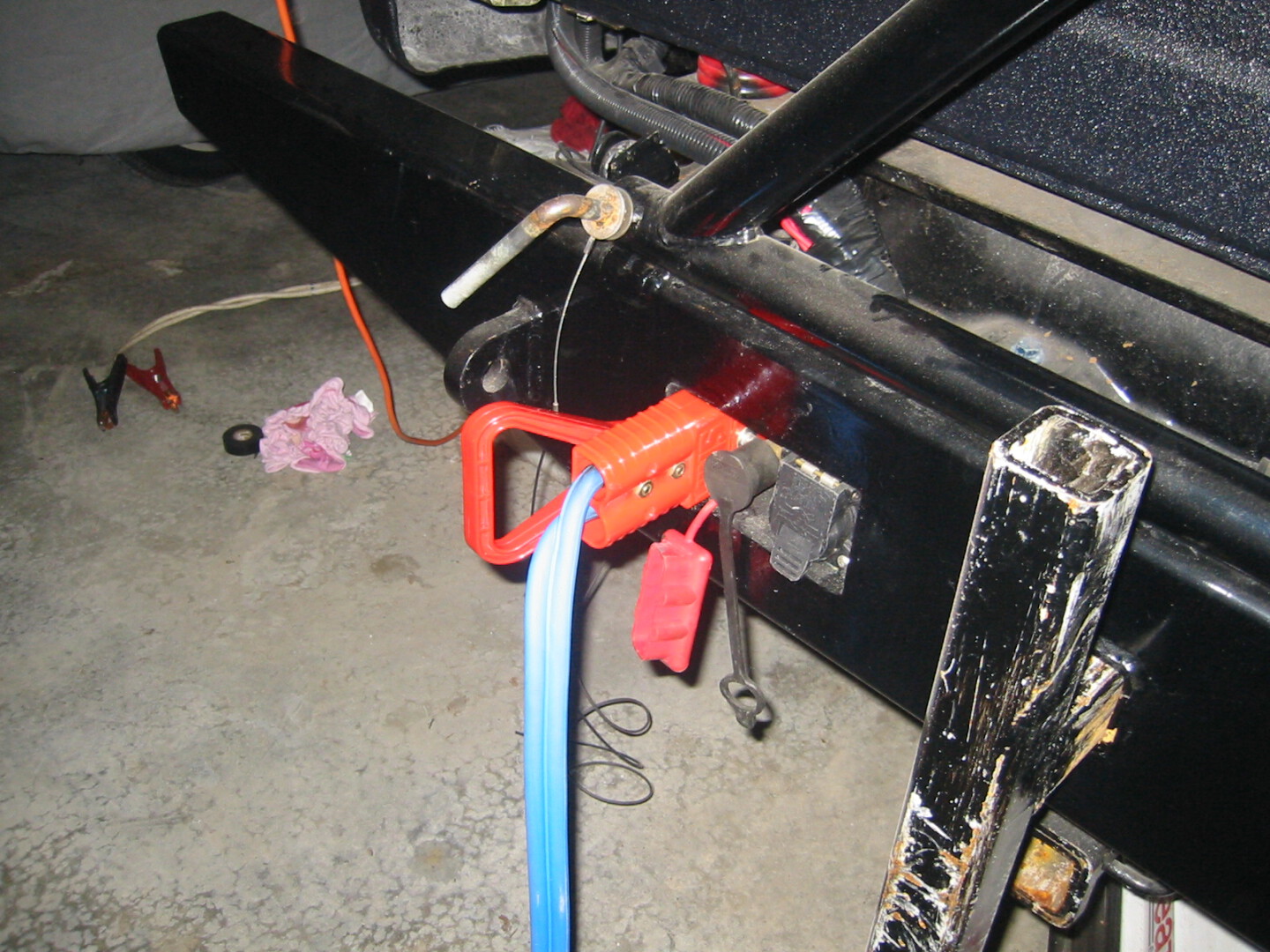

"Best" ones are home made using thick arc welding cable,like #00 with store bought GOOD clamps,that will actually stay on both side post and top post batteries..
If you shop at a scrapyard I bet you'll find some good used cable there for much less than new also...
I have several department store variety jumper cables I got from junk cars trunks,when those fail to get something to start I try the ones made from welding cables and the engine usually whips over like it has no compression,when the flimsy ones just got hot ,and it wouldn't spin over at all...beware of store bought cables that look thick,but have only 10 gauge or less wire with super thick insulation!..
I Agree with this! I made my own. I did a thread on this a while back: saying what I used and where I got the parts.
