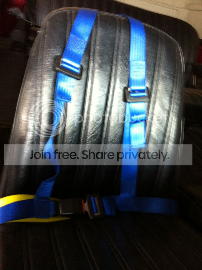

On a side note, I put 4 point harnesses in the front of mine within a month of buying it. I just plain didn't trust a lap belt with that steering wheel there. If I were to hit something I'd have had a nice steering wheel sammich, and I just wasn't too interested in that. Just a thought.
Thanks man, how did you get 4 points in the bench seat? Do you happen to have any pics?
I have buckets up front and bench in the rear. I only did harnesses in the front because 1: I normally don't have passengers in the back and 2: there's nothing to hit your face on in the back:D

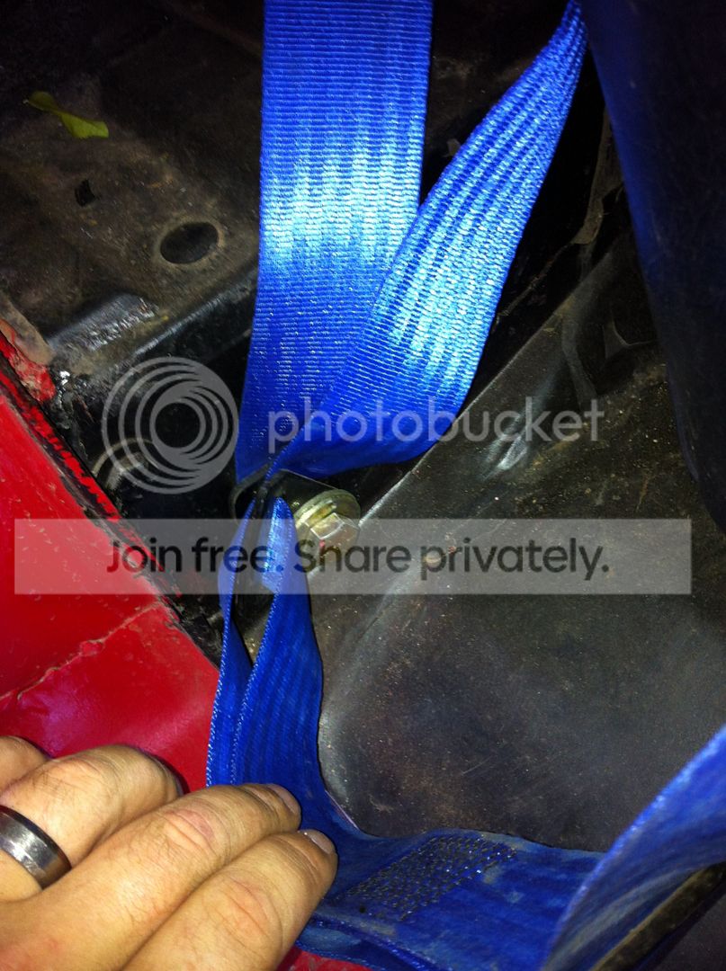

For the front though, I mounted each side of the 4 point through the stock holes where just the lap belts were. I can get some pics tomorrow if you want. It's so dark right now even with the light on you wouldn't be able to see anything...
I would think a bench would be easy with the harnesses though. Just run the belt portion through the seat like the factory lap belts and then drape the shoulder belts over the back of the seat.

Here are the pics of mine.
