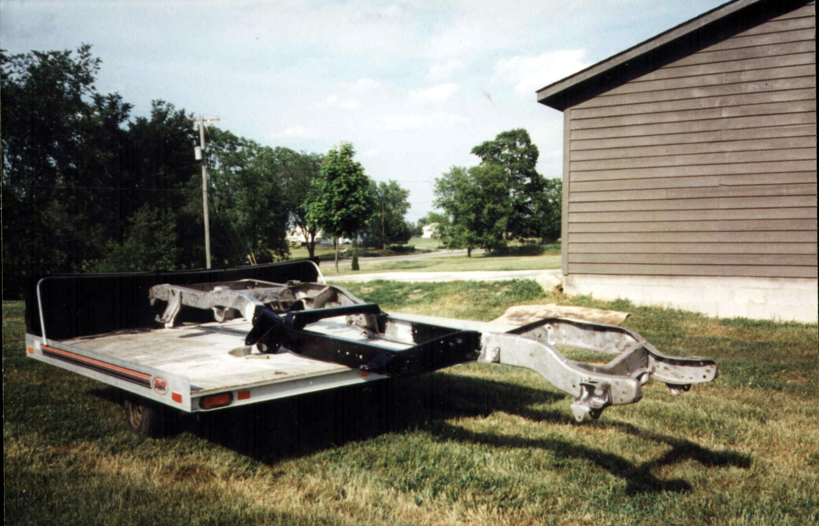

I did my whole frame, and all my drivetrain parts with it.
That was my initial test. I sandblasted my entire frame. THen I painted a section with the IMron rpimer (colorar or something) and the imron paint. Then I tried sandblasting it again. The imron just got faded and I pretty much had to point the blast nozzle at it for about 20-30 seconds straight before it started to come off, even then only to the primer. Took another 15-20 seconds to get through to the metal. Even then it was only a spot less than the size of a dime.
After that test, I was convinced, this is the chassis coating for me.
Mabey POR15 is just as good or better, I don't know, I've never used it myself. But I think the Imron will hold up just fine.
I sandblasted my frame and did a POR-15 job on it. You have to prep it good and the best bet is to use their etching cleaner too. I over painted where I wanted to weld in my steering box brace. First I used some MEK to try and clean the POR-15 off. The POR-15 wasn't even fazed by MEK. I tried paint thinner and acetone but nothing. I then tried a wire wheel on a drill and that didn't make a dent. I finally had to ruin a grinding wheel on my disk grinder to get the paint back down to the metal. So far, my axles and anything else painted in POR-15 have been stellar in lasting. But again, proper prep is the key. I've heard good things about Imron too.
