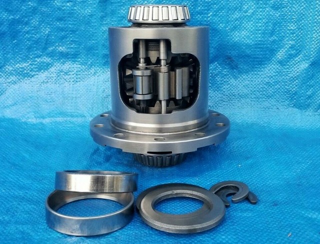

I have an Eaton E-locker in my front D60.
One advantage over the others is that it's easy to fix a ripped off wiring on the trail,
I've fixed it once with just a knife and some duct tape.
But with that said, I would probably get a Ox-locker, if I bought one now.
The E-locker has a design that allows the diff to unlock when changing direction.
At least in theory.
I'm not sure if it really does it as long as torque is applied...
But if I need to rock the truck back and forth to get loose while the diff is locked,
I try to be careful just in case...
Had an elocker in my d60 and it failed. It was never abused, at some point it just wouldn’t engage. Coil was replaced, still wouldn’t engage squarly, the armature would cock to one side and bind. Worst part was Eaton would do nothing except sell me another one. Had a Detroit in the rear 14b, didn’t like it when driving on snow covered roads.
Once the Eaton failed, went to ARB’s on both ends. I really like the ability to choose which end or both. Kind of like being single vs married.
