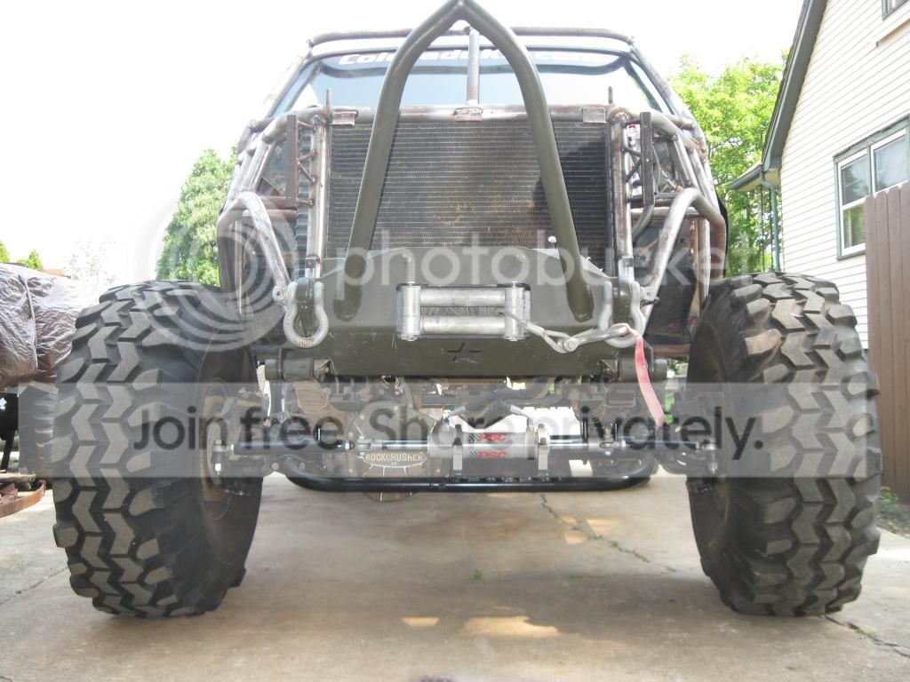

I'm running pretty close to the same setup. Stock TBI350, heavily modded th350, 203/205 doubler, 1 tons with 5.13s and detroit lockers, 35 spline chromo stubs & flanges up front. 52" springs & 64" springs, anti wrap bar, 1410 u-joints all around. I run 42" TSLs. But I also have a set of 38.5 boggers I will be running at The Cliffs (because of their tire size rule) No real street driving so I can't comment about that.
Flanges are fine with a detroit since you will be in 2wd on the street, the locker will just freewheel and won't affect turning at all. The tires themselves will affect turning though. I recommend hydro assist as soon as possible. Wheeling my truck with 42s and regular crossover was difficult at times. I now have full hydro
So its probably best to just skip the crossover and go full hydro to save myself some money and problems in the end?
Who did you go with for your full hydro? How do you have the ram mounted with leaf springs?
Full hydro is not recommended for street driving. I got my kit from PSC. I can't remember off hand (truck isn't at my house so I can't check) but I think I went with the 2.5" diameter shaft ram kit http://www.pscmotorsports.com/motor...le-end-steering-cylinder-kit-with-p-pump.html
The ram probably could have been mounted up higher if I went with the double shear steering arm kit from Artec, but it's big bucks, which I didn't have at the time
Sweet Jesus... look at that rig! I will definitely be reading every page of the build thread for your Trazer!
How do you like the full hydro and leaf springs? Does it give you any issues?
Thanks man. Can't really comment about the hydro yet, truck hasn't left the driveway since the install :doah:
