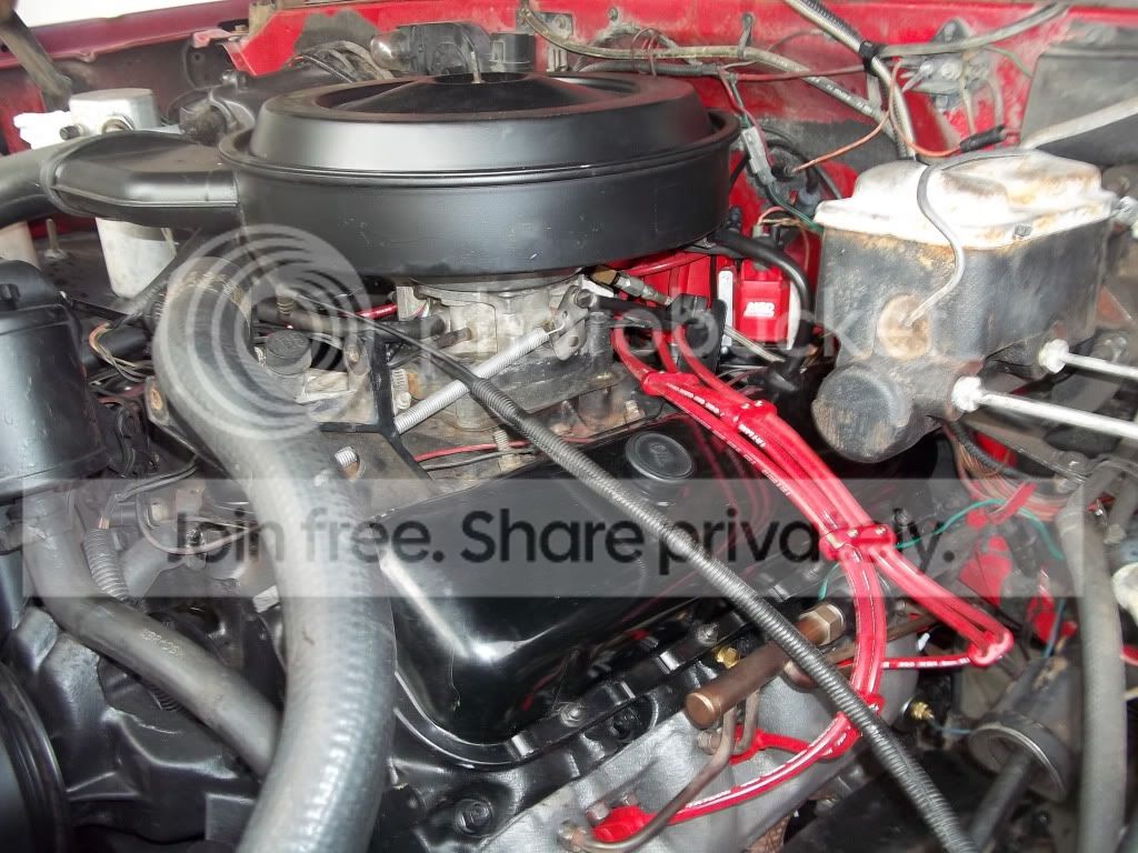

I like MSD, Delco or Taylors.. the Taylor's I recently did...
