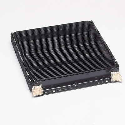

I believe the consensus is the stacked plate style. I've always put B&M kits on my trucks, getting the biggest I can fit. If it gets COLD where you are (Dallas? I doubt it) some folks will tell you that you could have too cold fluid ... unless you're in Alaska or Nebraska, I doubt it. I believe that there is no such thing as too cool tranny fluid ;)
If you're buying from Summit, look at the "racing" models that don't come with all the plumbing stuff, as you're gonna be piping it anyway -- cheaper that way.

Definately a stacked plate cooler. Having a fan on the cooler really doesn't help much except at idle when there is no air flow across the cooler. Even with the cooler mounted under the bed there is plenty of air flow there while driving so i wouldn't waste money on buying a cooler with a fan attached or buying a fan separately to mount to the cooler.
By the way, trans fluid can be too cold and ruin a tranny. The fluid needs to reach a certain temp (usually around 160*) to burn off any moisture in the fluid. A temp guage would be ideal as well and try to keep the temps between 160-180* higher when climbing hills is expected.
I use these..
http://store.summitracing.com/partdetail.asp?autofilter=1&part=BMM%2D70274&N=700+400004+4294888847+115&autoview=sku

I use a B & M stacked plate. To keep tranny fluid at the correct temp when it's cool out, I have a thermal bypass valve installed as well. No fan.

OK, I'll try that one. I am putting two trans temp sensors on my truck, along with a Mag-Hytec double deep pan. My trans has a non lock up converter, and when pulling my trailer with Blazer at the non overdrive speed of 65, I'm thinking I need all the cooling I can get. I can always add a fan later and If I get the 160* thermostat for it, it should be right where it needs to be. Thanks guys.

stacked plate has more cooling surface area- plus flows a little better- Some of them have designs that go automatically into bypass mode if it isnt past a certain temp. Trans temp gauge is definately worth it, you can get the permacool remote filter + gauge pack.
Uses fl1a filters, takes the pain out of changing filters.
