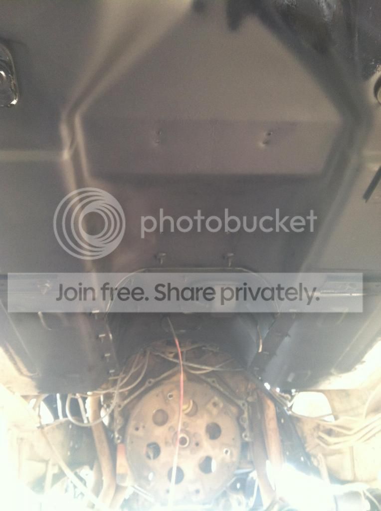

I used a 4-1/2" angle grinder with a twisted wire wheel to make short work of it, then I used rust converter and spray on liner (rubberized paint).
* be sure to use goggles, long sleeves and pants *
Those wires hurt when they hit you at high speed
Here's a pic of the first section I did before putting the transmission back in.

Before I get to a wire brush what chemically would be advisable? I'm looking at 3/8" of grease and junk caked on around on average down there. Really baked in too, 30 years of it.
With it that thick you'll probably be better off power washing it w/ a good cleaner/ degreaser first.
A putty knife or paint scraper, to knock off the heavy stuff then just get after it with the wire wheel. You'll find high speed wire wheels are very effective at removing rust and getting down to bare metal. Chemicals like degreasers and solvents can make a big mess.
