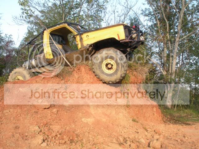

get 0 to 1 inches ouf lift with 52s? i think 38377k5 has 0 to 1 on his rig, clearance and steering isnt a issue.imma let some N2 out of my shocks and lower the whole truck down about 4 inches.the rest of the body will be gone and replace with tube and steering will be done via full hydro.so with htat being said whats the best way to net 0 lift with 52s? if i can find a option i will link the front just to cheap for that right now
Mine is that height, 3 leaves plus the overload. It sits flat on the overload at ride height (though we are using used springs so the condition of the springs will likely affect this).
Very little uptravel, tons of downtravel, actually works fairly well.
Keep the overload, without it the springs will overflex and you'll kill them the first trip out.
well im lowering for the cog.as far as belly im at 27 inches and 120 inch wb.i will be at 124 after i do the front but my tires are bald 42s so hopefully after new tires i will gain back what i loose.i still think a 20 inch + belly is plenty for east coast wheeling.ive never hit mine now and dont mind dragging it.actaully i did hit it here :D
well id rather have bad ground clearance there and feel more stable on climbs and sidehills.i think from where my truck is now it would lower it about 9 inches :D
