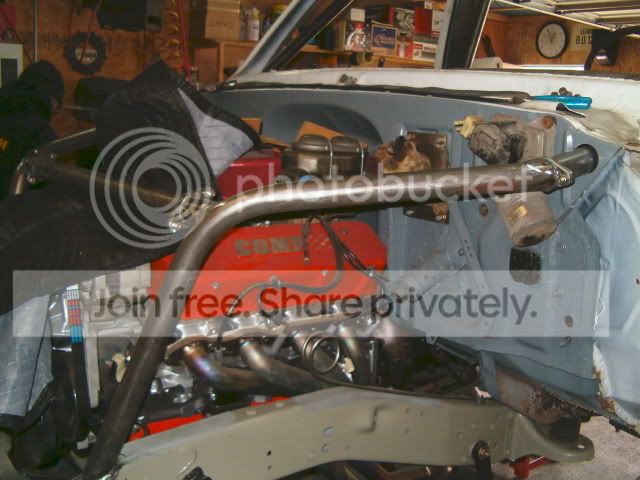

We just dropped the body on my buddy's k5 yesterday. The 454 valve covers are really close to the fire wall. My dad was talking about having to beat in the fire wall due to the blazer never being equipped from factory with a BBC. Did anybody have to relocate engine mounts/cut the fire wall to make it fit.
Sorry I didn't get a close pic of how close the motor is to the body

Though they probably didn't make any big block K5's,if a big block will fit in a pickup it'll fit in a Blazer--you may need the right combination of motor mount brackets for the engine and bolt them in the right holes on the crossmember ,and yes,the valve covers do come very close to the firewall,but factory ones should clear ok...
A friend of mine and I put a 396/402 from a '71 Monte Carlo into his '75 K5 and it fit,it was a tight squeeze,but once it was in there nothing rubbed or touched (except the headers,on the front shackle bolt)..the oil pan was real close to the front crossmember,but you could fit a finger between it still..

The engine compartment of a Blazer is the same as any other model square body of the same year so there are no fitment issues. As stated, it's the aftermarket accessories like tall valve covers that create issues.
I've got a 454 in my 91 with zero problems. I do have a 1" body lift but I decided to use that for ease of working on the underside of the truck (bellhousing bolts, exhaust, clocked tcase, etc).
Raise the tranny a bit, rock the front of the motor down...
I think it's the valve covers as well...he has a 2" body on it that seems to have made it a little better...just wondering if anyone had a problem before.
Check the angle of drivetrain, shoot for 4* or close to it.
How tight is the distributor?
You should have no firewall issues if your angle is good.
I used DIY4X competition mounts....they are stout pieces!

Mine is a stock 454, no body lift, didn't move the mounts forward,and used factory engine mounts for a small block, fits no problem.
The suburbans come out the factory with big blocks and there are no clearance issues.
