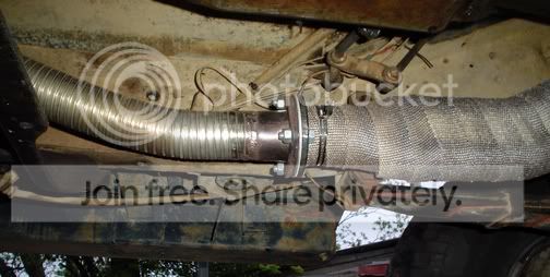

I tried steel flex once and it worked great but only lasted about six months before rusting bad enough to blow out! This time I'm trying 304 Stainless flex made for saltwater exhaust marine engine use. Working good so far............we'll see how long it lasts!
