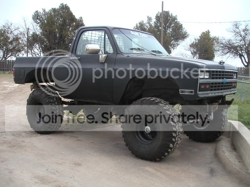

These are 37" MTRs on 17x8 Allied beadlocks. The lift is a 4" superlift with Bushwhacker flares.
The flares allows me to cut about 3" out of the front and rear of each fender well. (nice since it was mostly rust anyway:wink1: ) Nice option if you want it to look clean and uncut. Plus the flares hide my air saw skills:eek1:
