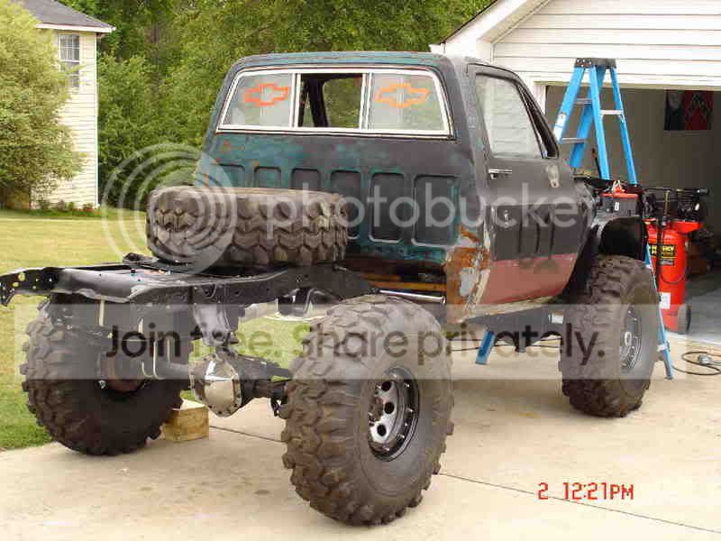

Got the rig up on its wheels for the first time. Just some eye candy for you pic whores.

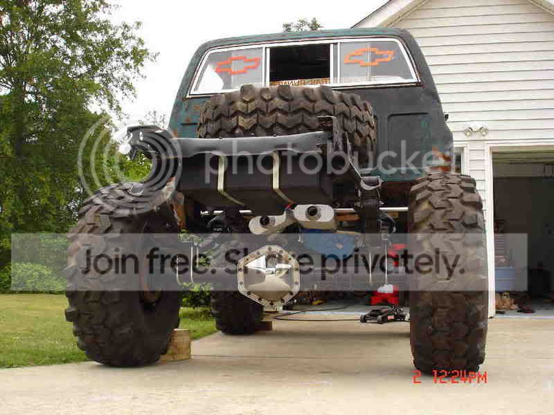

Yeah its a 16gallon fuel cell.
I have a crossmember built to support the rear of the cab on the k5 frame, just still need some help welding it in. Got some 2x4s in their right now. lol.

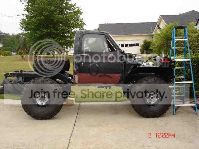

Might want to gusset up your redneck shackle flip
that and your shackle angle sucks. you have no droop left. either move the hanger forward on the frame or get longer springs.
Yeah, its just ghetto fabed for now to get enough lift. No money into it, just torched the old hanger out and flipped the shackle. Going to get the rest of the truck finished first before I go 56"rears and 52's up front. Theres a lot left to do and a lot more money to spend until its even driveable.

Might want to turn the fuel cell around to have the lines coming out the back instead of facing the front.
