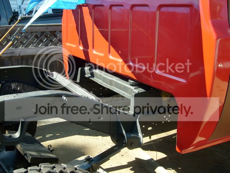

You'll have to fab up or transplant the rear cab mounts. Outside of that, I think its a bolt on.

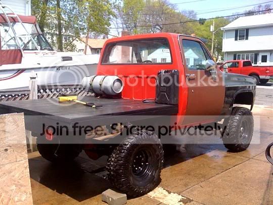

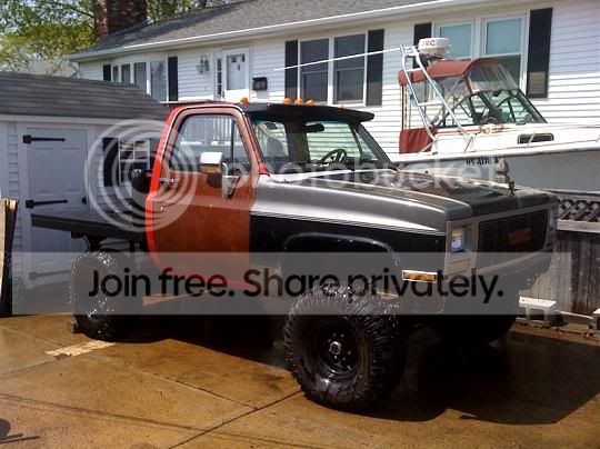

I did exactly that. What part of NH are you in? Stop by www.nek5.net, it's a growing board for the locals :wink1:
here's the xmember that a member here made to put the p/u cab on the blazer frame
