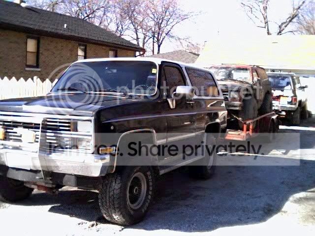

My Blazer is my tow rig (don't ever buy a Jeep Grand Cherokee and think it can tow :mad:). I tow everything from a 10' or 22' snomobile trailers, all the way up to a 25' car hauler. Pulling the Camaro to the track isn't that bad. With the 4 place snowmobile trailer behind it, a good wind will cause some sway. But I think thats more a weight distribution/trailer height issue.
The biggest complaints I hear about towing with a short wheelbase, is that the vehicle sway excesivly. If you get the proper tounge weight and the tounge at the right level with the hitch, you shouldn't have any problems.
Blazers got 4.88's in the 14B FF along with disc's out back. I've also got a shackle flip on it. I've heard towing is bad with a shackle flip, but I have had no troubles with it.
