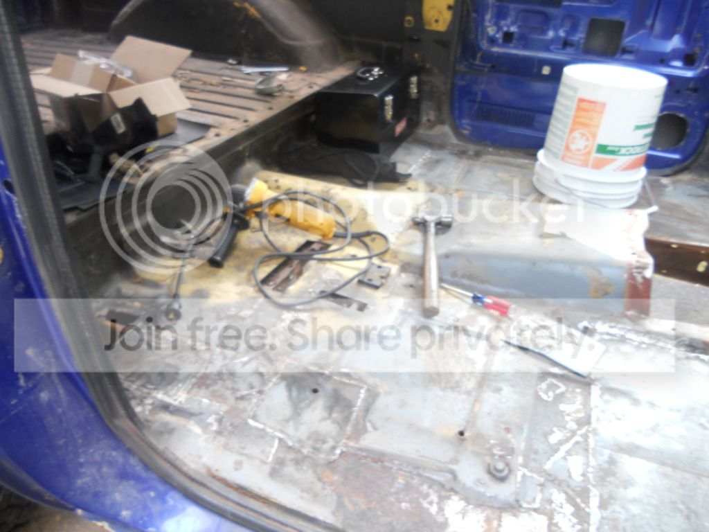

1978 Blazer. Anybody got a picture handy? Floor changed in 1978 just wondering about the rockers and I don't have anything that old around the shop any longer.

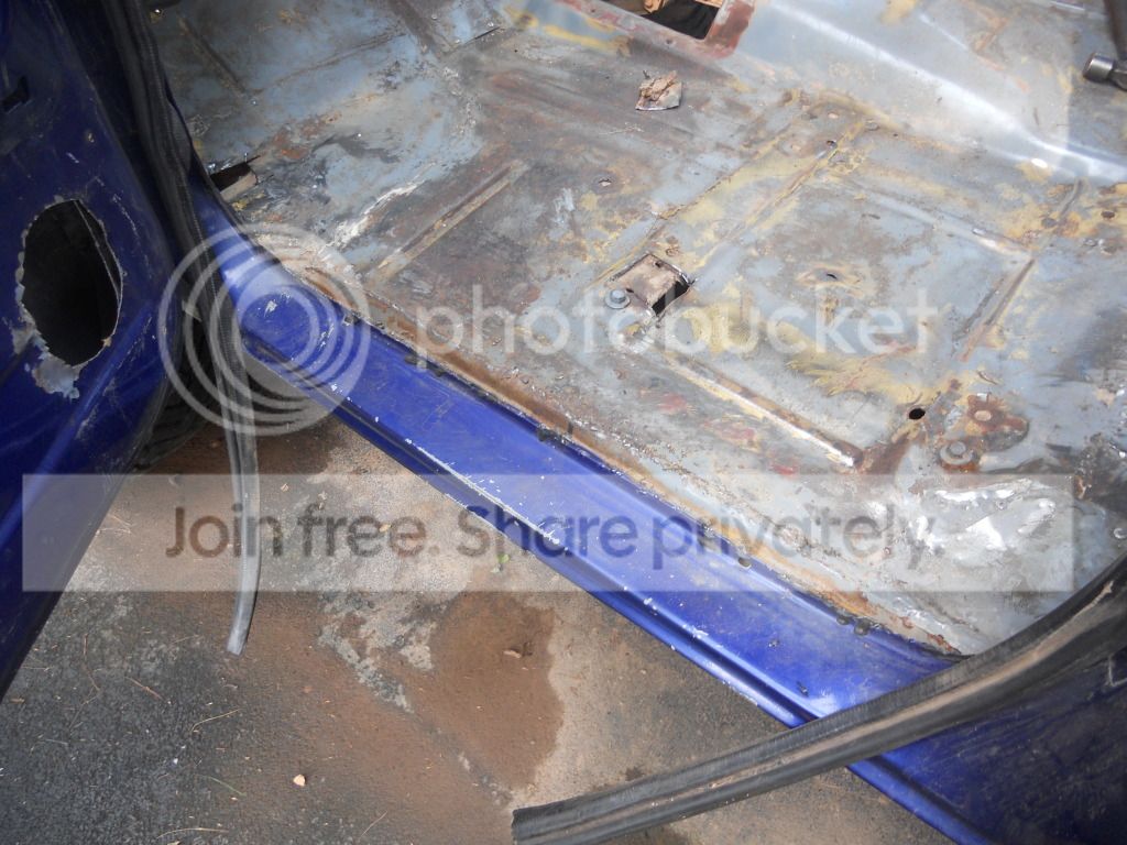

Not the best pictures and im not sure if these have been replaced or messed with over the years but heres what i got:
Hope that helps.

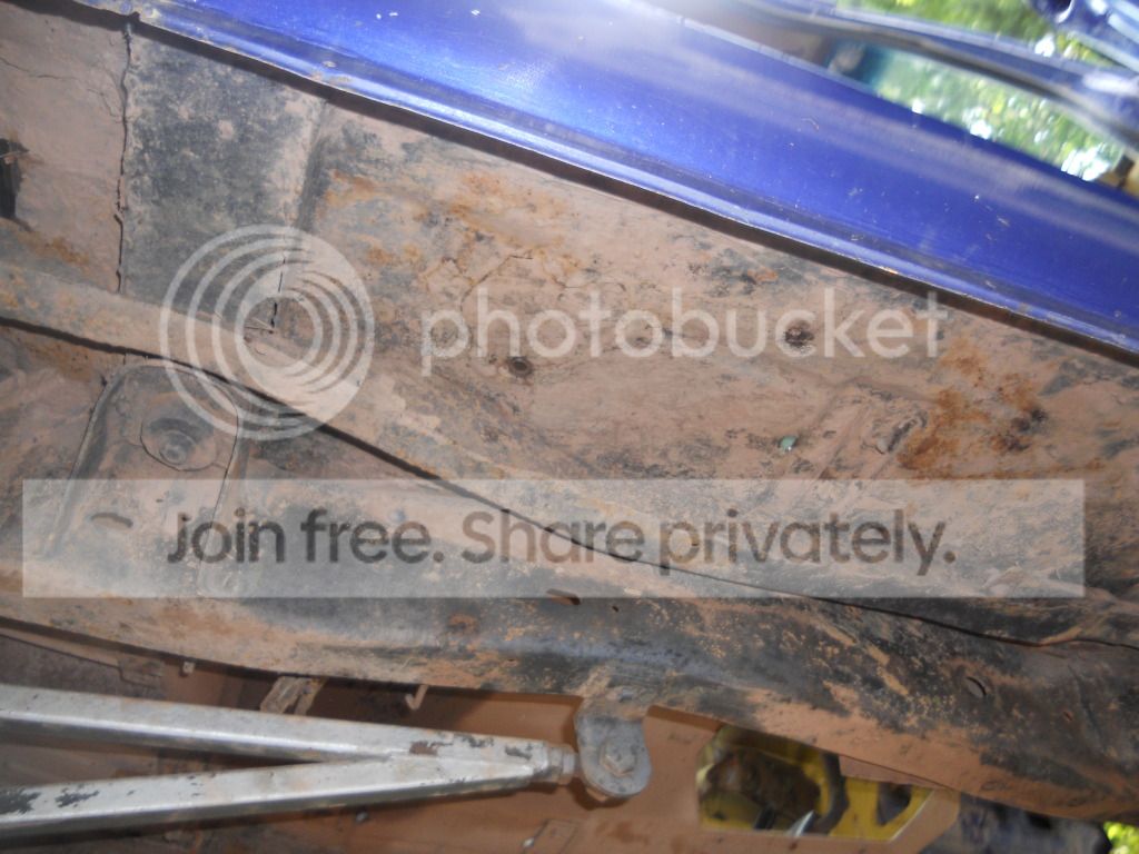

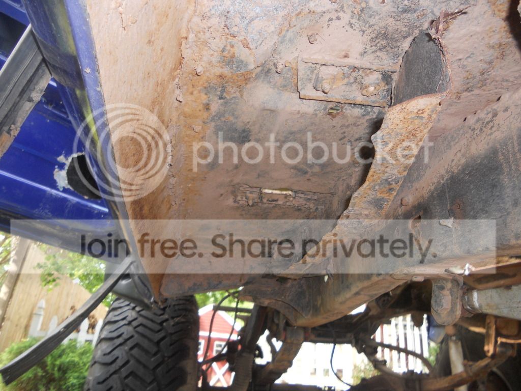

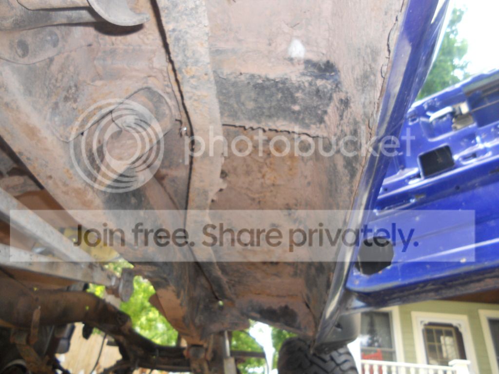

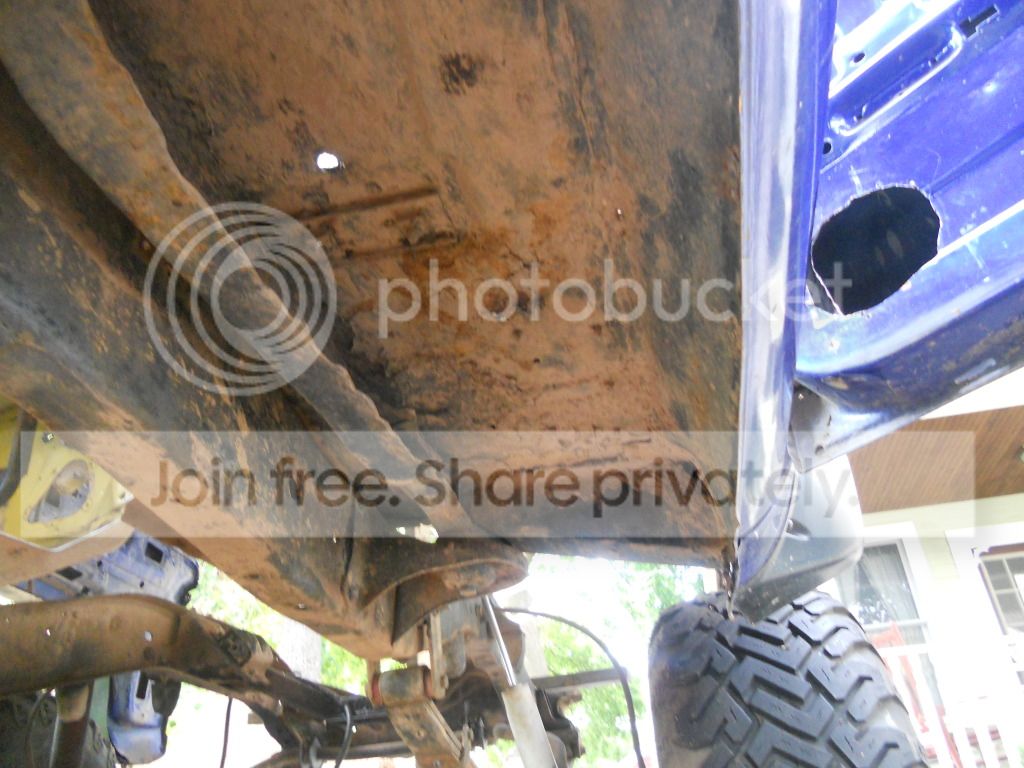

Hope that helps.
Don't look like they've been messed with. Thanks for the pics, it does help. Got another couple emailed to me and looked at some other sources and they all look identical.
so that inner piece that just hangs there is suppose to be like that?
The piece that looks like a "C" channel hanging down near the frame. Runs parallel to the frame? YEP!
Yours looks a bit rough but it is supposed to be there.
