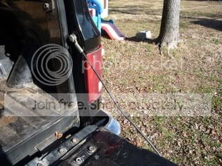

Here are the tail gate wires

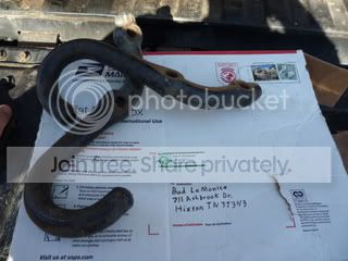

Tow hooks from 1967K10, Kyle Strasburger.

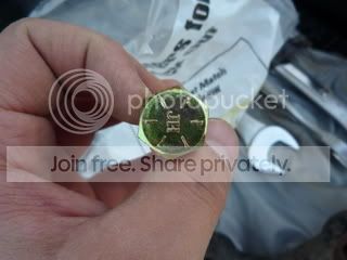

Grade 8 bolts.
Hooks Installed

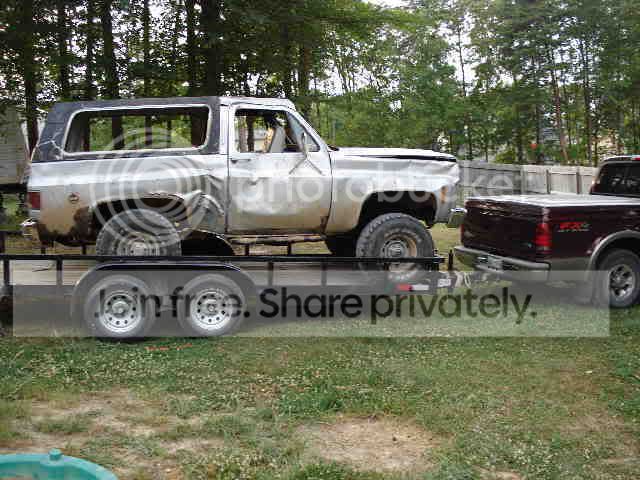

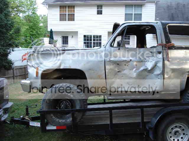

Cheezy Ghey picure before the wreck. 1976 K5.

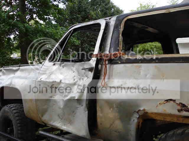

After the wreck

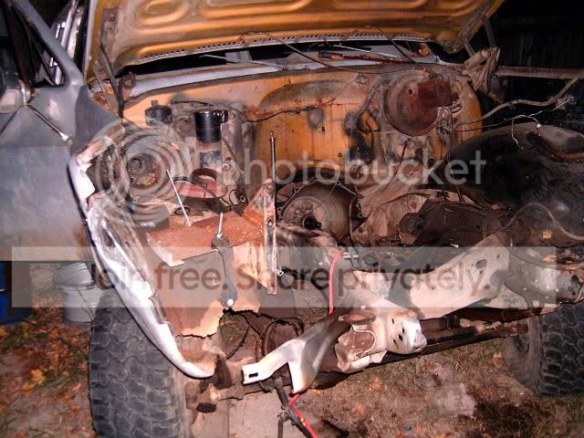

Pulled 350 out of old K5

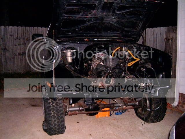

Engine swapped into 1986 Spencer, tires low to allow clearance.
Ouch! Wreck looked like it hurt.
on another note....Is that a stick on cowl hood?:screwy:^^^
Yes the wreck hurt, but no worries I only landed on my head. So nothing important got damaged.
Yes, I think it is a stick on cowl hood. It was like that when I bought it. It kind of looks natural in this part of TN, I haven't really done anything major to the truck except the engine swap, it was my first and went according to plan.

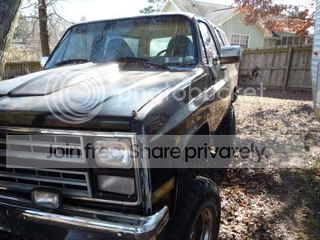

As far as what I have planned, let's start with the current condition of the truck:
It has a strong stock rebuilt 350, SM465, NP208, 14 bolt rear with disc brakes, 10 bolt front with 8 lug hubs. Gearing is 4.1
Tires are General Grabber 35 x 12.50 on 16.5" wheels.
The springs are really stiff, and give the truck about a 6" lift over-all, I think that the rear springs may be from a ton truck.
I don't plan to do really aggressive driving with this. But safety is my new greatest concern.
The truck currently has some kind of bench seat from a F-150 maybe in it.
