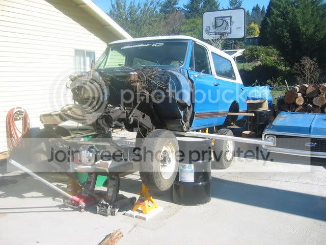

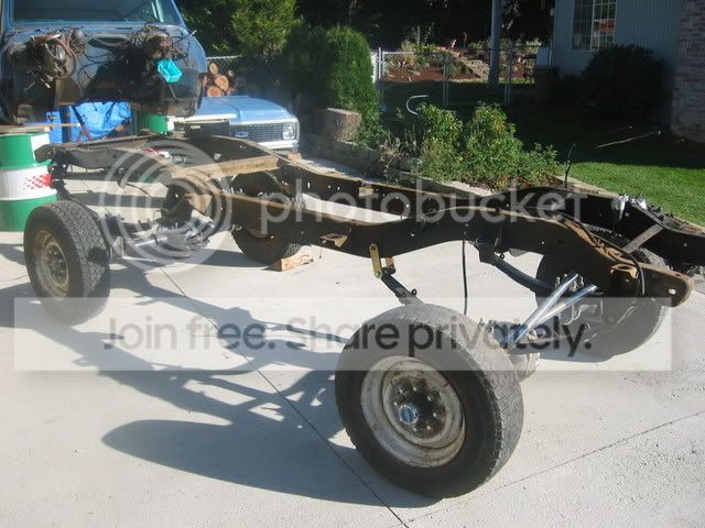

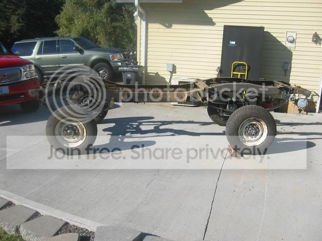

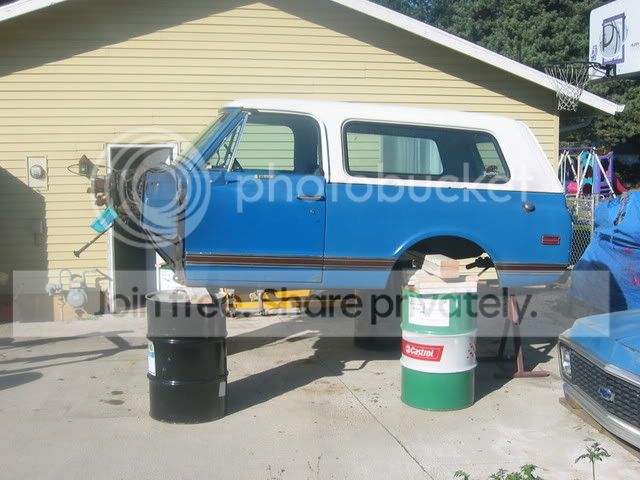

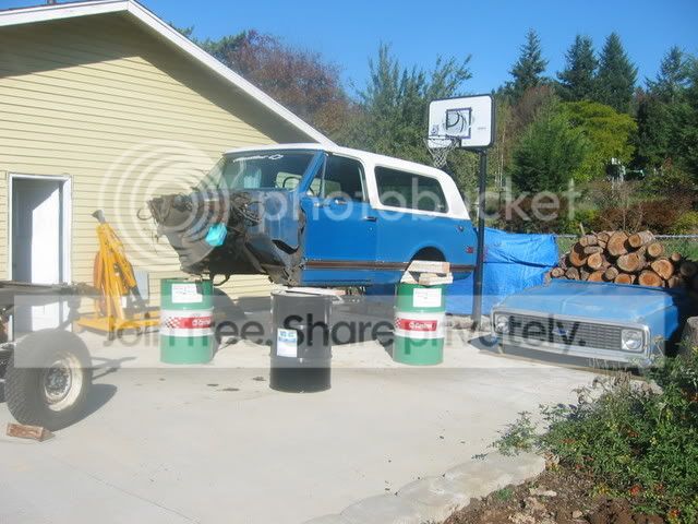

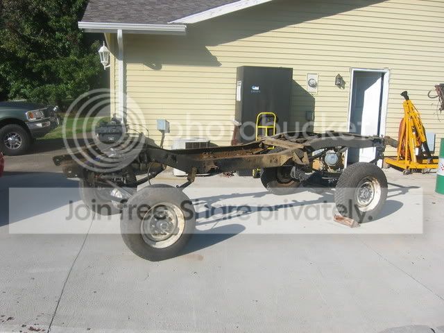

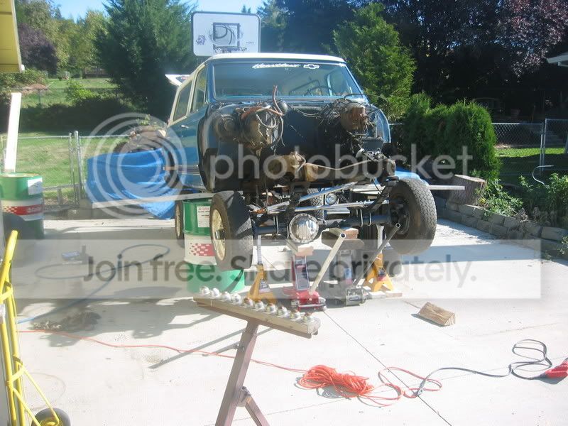

So figuring today would be the last nice (read non-rainy) day to fall on a weekend until Spring, I was bound & determined to get the tub off the frame TODAY!
And I did it all by myself - wasn't quite as bad as I thought it would be. :rolleyes: (RIGHT...!)

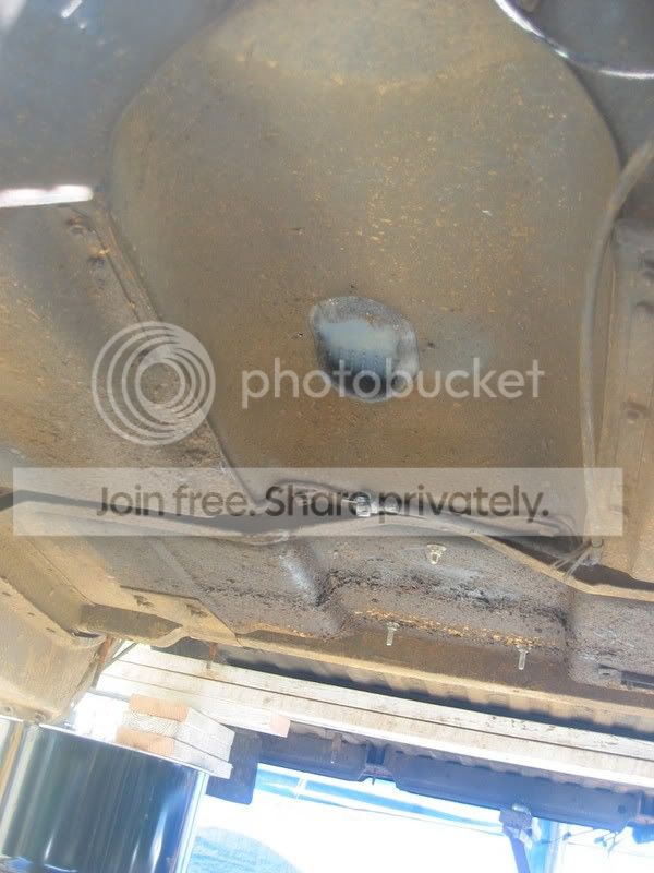

CROTCH SHOT!
I used a cherry picker on the rear end - took out the rear seat and used my engine hoist in the seat bolts.
And as you can see from the pics - just jacked up the front until it was high enough to get onto the drums - then lowered the frame out from under it.

Good to see you get the body off - it always amazes me the inginuity that people come up with to get a job done alone. I do most of my work alone too, so I appreciate what you are doing.
awesome idea, but i got a question, how do you plan on rolling that chassis under there with the drums in the way?
Very good question. I was wondering how long before someone would notice this.
Since I sloped it down - most of the weight is in the back. I also placed a few shims between the boards on the driver side barrel so that most of the weight of the front was on that barrel.
Then I was able to remove the passenger side front barrel and the Blazer was free-floating on that side. For safety, I hooked my engine hoist to the passenger side hoop step and put a little weight back on it.
I admit this was not the ideal way to do this - but I was able to sideshift the frame and roll it out very quickly with my two floor jacks.
I then placed the passenger barrel back, and took the engine crane to the other side hooked to the hoop step - lifted the body just a hair, and removed the shims.
The other alternative is to pull the rear axle and re-install it when the frame is re-attached to the body.
When you go to reinstall the frame under the body, why not get some longer boards (or steel if you have any) and move the barrels out further.
Problem with that is - I don't have a way to lift the front like I can in the rear with the engine hoist. I'm not really comfortable using the engine hoist on the step hoops and totally removing the front barrels
use the cherry picker and go through the floor to a cross beam lift it up and slide the barrels out.
