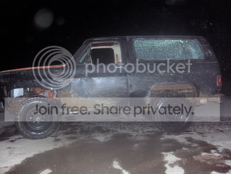

put a 3"bl on my friends blazer in one day. it wasnt that bad, all that took long was welding in the extension on the clutch rod
heres a pic:
