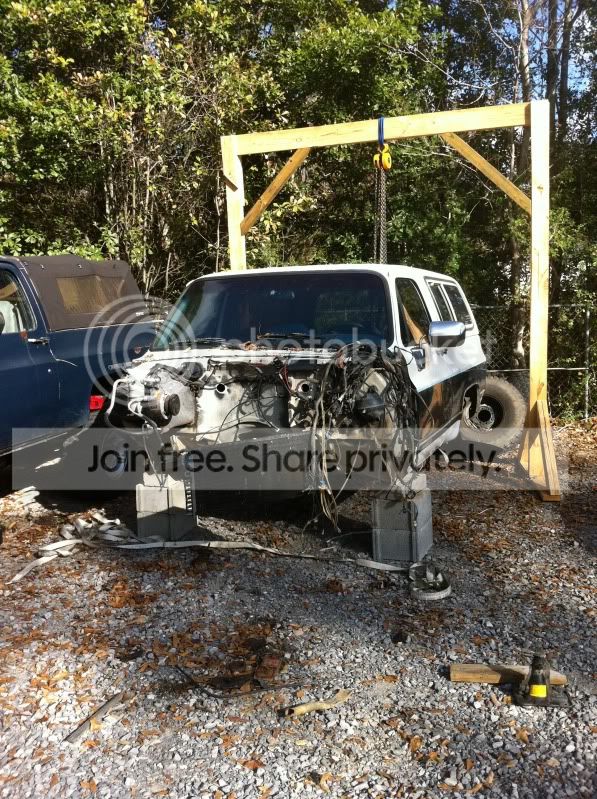

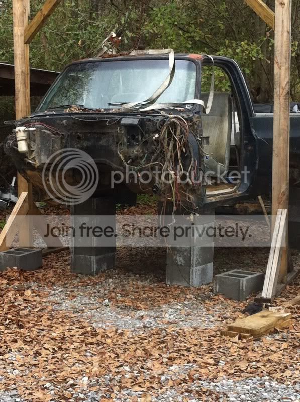

I probably won't be much help, I'm swapping body's, so I stole this frame idea from someone on here . I built the frame and used a chain hoist to pick up the body and roll the frame out.
I kinda think it's a good thing that I took the body off. In the body mount for position 3 there is a cage that holds the nut inside of the body, well one of the cages in the body that I'm using broke free and the nut would just spin, so I have to cut the body mount bolt. Then after I got the body off I had to cut that section out, reweld the cage, then weld it back into the body.
