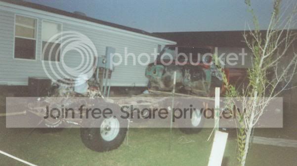

I removed mine by myself, I used our trx300 4x4 with the winch to tip the body up on the frame, then just worked it off the side onto the side of the body, worked well for me and didn't break or dent anything. forklift sounds like a good idea. good luck.

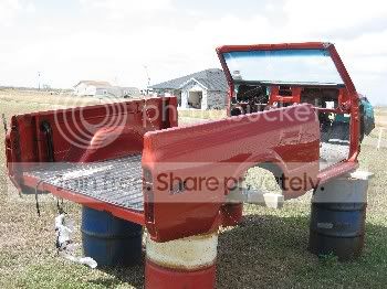

I used 4 empty 55 gallon drums a bunch of small 4X4 blocks, 2 long 4X4's couple cynder blocks and an engine hoist.
