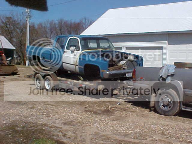

I'm stipping down my :crewcab:crewcab to a bare cab. There is some tar under the rubber door seals plus around the a/c box and I'd like to get it removed.
What works the best chemically? Actually, I think I can get all the sealer around the a/c box by scrapeing but under the door seal is soft and very sticky:1zhelp:
