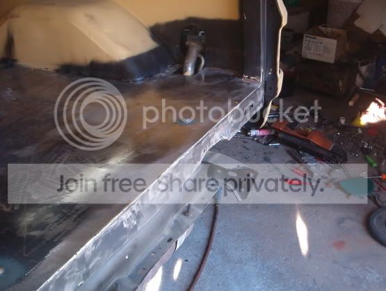

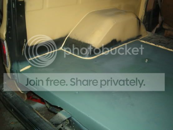

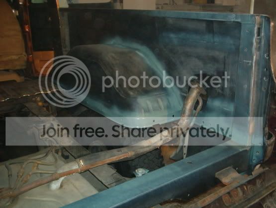

that's called the tailpan... every K5 on the planet has them rot... well, unless ya live in AZ...
LMC, and all the other taiwan stamped sheetmetal providers sell it.. http://www.lmctruck.com/chevrolet it runs around $90 iirc... the quality of that piece is actually pretty good...
tho it has some bolts, some welding is definitely required.. iirc, it has 2 bolts at each end, the 2 mount bolts, a weld bead at each C-post and then spot welds holding the floor to it... and no, the body doesn't need to be lifted to do it.. tho getting it out and leaving the very back edge of the cargo floor intact may be difficult... usually the rot has fubared that section of floor anyway...
here's a couple pics of mine going in, when I did my custom rear floor...
