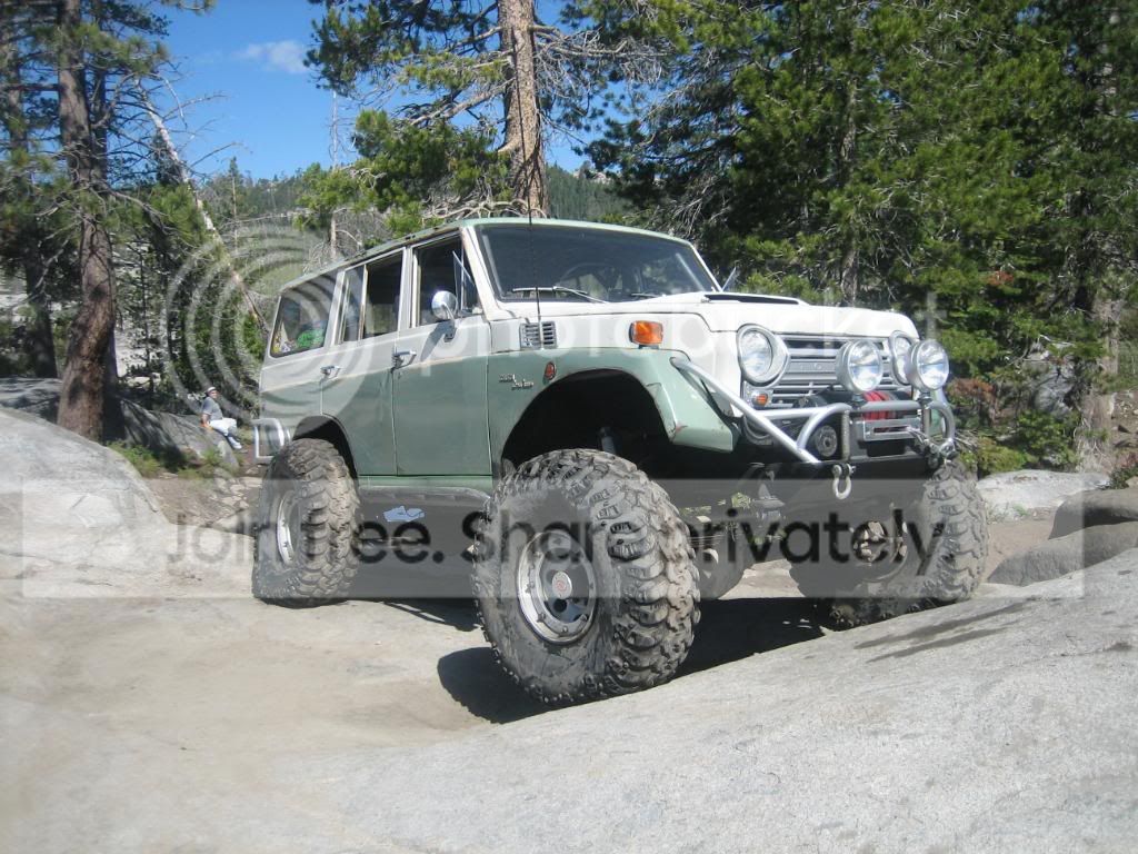

One of my good friends was in a similar situation with a soon to be growing family. He had a great wheeler but it was small so he started looking around and whatever popped up for cheap that had room was getting swapped on and he ended up with this...
'69 FJ55 on a blazer frame with his built drivetrain.
