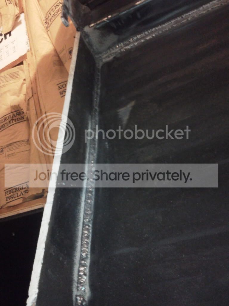

The stuff that is building up is the Flux that is protecting the weld. Not the best pic but these are done with Flux core wire.
It took a slight pass with a wire wheel and it knocked off the brownish grayish flux off the weld. With Flux core wire your actual well is being hidden by melted flux
