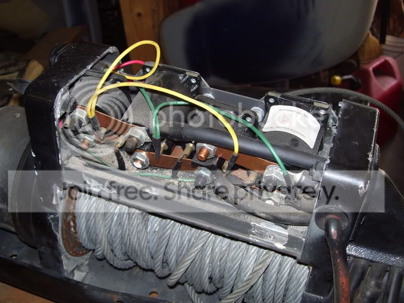

there is no remote...the part that it plus into...has the 3 prongs, constant power and 2 for the switch rev adn forward? i was just jumping them with a screwdriver...

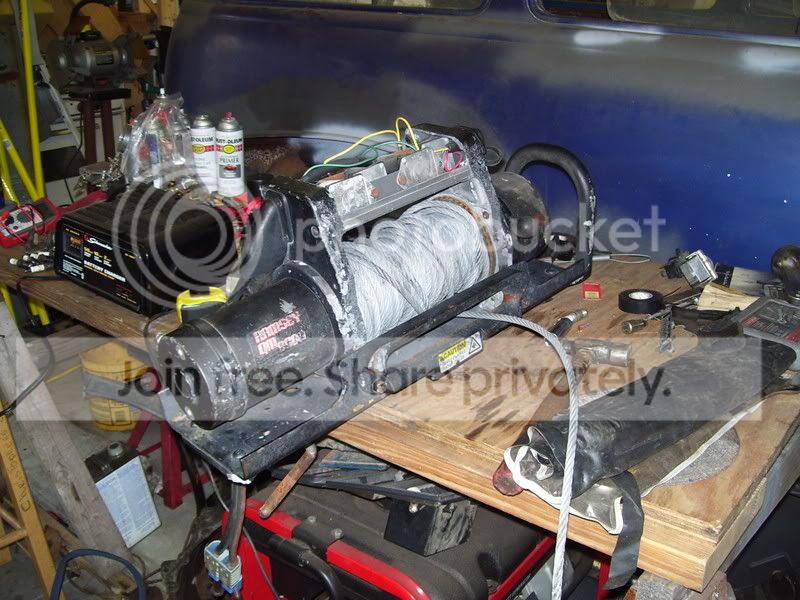

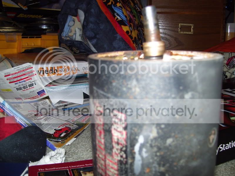

Welp...i pulled the motor off the winch today and heres my problem! haha
im gonna start doing research on it, i would rather take it somewhere local and get a new armature/rebuilt.
but we shall see.
heres the rest of it...
There's gotta be an automotive electrical shop with a Romaine account that can get you the armature. go to Romaine electric on the web and you can search for a local shop. Save you some money, and it will be a local shop.
