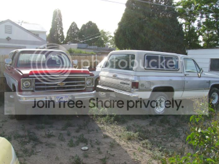

My buddy picked this up recently and I was able to wheedle him out of it. It's a 85 silverado edition 305/700/208. The white one, the red one is my 78 k5. All the windows and doors work, inside looks cherry minus 2 things and the best this is no rust at all. However it also looks completely stock in the engine bay. It even has working ac! Not that I use it but it's nice nonetheless.

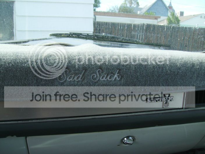

The best part about this k5 is the awesome dashpad cover. The "Sad Sack Blazer"? :haha:

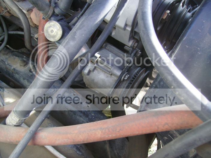

The smog stuff. I'll have to get a better pic tomarrow.
Anyone know what this is? It isn't connected at all.
That looks to be the smog pump hanging out under the alternator. Not sure on what you have for emissions out there, but you can pull it off and cap the lines if you don't have to pass any checks.
No belt on the air pump,so its "disabled" already anyway...
Sometimes disabling all the emission crap makes an engine run worse instead of better--the fuel air mixture and cam profile are designed to work with them...as long as the vacuum hoses are not cracked and leaking and the things they operate still work,I'd just leave it be...someday you may need to pass a "visual" test and regret having removed all the emission stuff..
Out of all the devices,the EGR valve and air pump are the two that detract from performance the most..the EGR valve can be left on and its hose plugged with a ball bearing,and the belt off the air pump will keep it from doing any after-burning ...

The air pump adds air to the exhaust so that the cat works better. There are two check valves that prevent the exhaust from backing up into the pump.
The air cleaner diaphragm only closes off the air cleaner to cold air when the engine is cold. Same goes for the heat riser valve on the exhaust, if you have one.
Charcoal fuel canisters adsorb vapor and then let the carb/tbi suck it back up. The engine is tuned to run with these in place.

The egr can help prevent detonation, but it could also cause accelerated wear, possibly in the cylinders near it. The ball bearing trick is good, or just cap the vacuum line to it. It is better to tune the engine to not need the egr to help with detonation, assuming the engine is built properly for the application.

305 should have the ESC setup (knock retard) among a lot of other things, and it's just best to leave it all alone. Removing EGR without messing with the carb causes a part throttle lean surge, removing knock function means replacing the distributor and with bad heads/high compression could lead to engine issues, etc. AIR really doesn't present a problem (especially since the belt is gone) to remove unless the converter is tied into it. Probably all sorts of thermal vacuum switches and what not tied into the choke and TCC. The emissions/hose routing really sucks that vintage, which is why TBI is such a smart swap, it cleans up the engine bay immensely.
