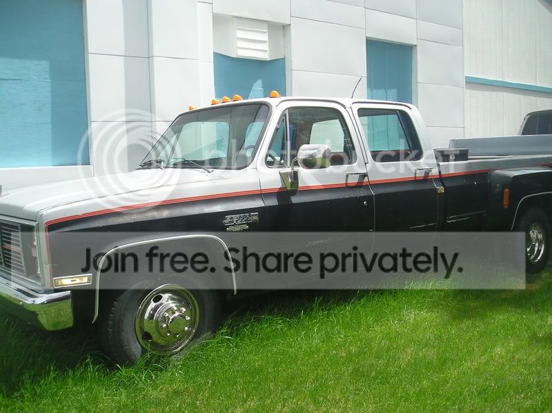

here's my junk
took the dually bed off today - planning to install a fleet side bed this week. 14 bolt srw. 4.10s and 60 up front. 91 cc. build to come...beamer silver paint 6 inches of lift, 37s, and my 4 year old has requested purple seats...we'll see

greywolf said:
here's my junk
Just put stock HMMWV wheels on it with the existing axles. No need to change to SRW front or rear and you have cheap double beadlocks:D .
