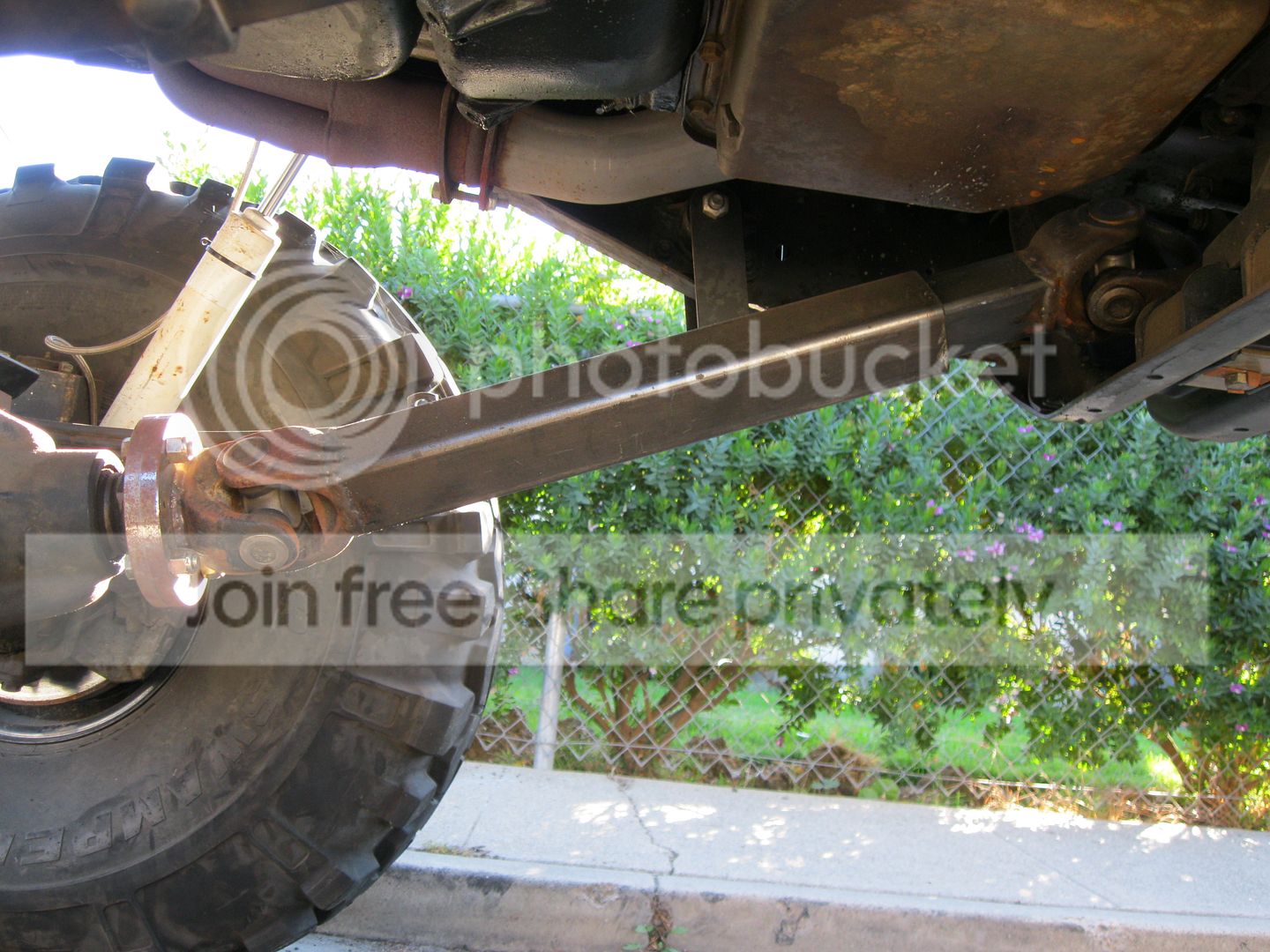

Mines a front shaft. Definitely trail only, or front with locking hubs. I have drive flanges and at blazerBash the guys said they could here the clattering of the shaft over the tires. While driving I never could hear anything other than the driveshaft, ever.
When put in 4wd, so there is pressure on the shaft, it's quiet, but with the hubs engaged and in 2wd, Dam it's loud.
Did I mention it's LOUD!!!

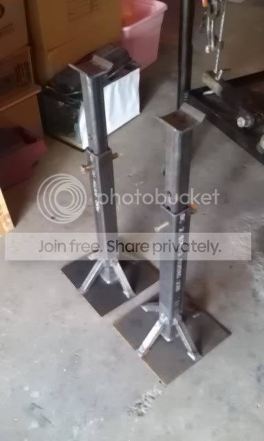

You can get 2.5" .250" wall seamless receiver hitch tubing that 2" .250" wall slips VERY nicely into. That's what I built my jackstands out of and the fit is great with the outer tube being clean wall on all 4 inside walls.

I agree. I ran one in my chevy and from the moment I finished it I didnt like it. Its not that there was anything wrong with it other than being huge, I just felt like I was really half assing something.
AND just for the record mine was super straight and centered and could be driven up to like 30mph with no bad vibes.
I used 2.5 x 1/4" wall reciever tubing and 2 x 1/4" for mine when I had it. Too heavy and too much noise for me though. But it was cheap, strong and had lots of travel.
I have since built one with long travel splines so I dont have to listen to it clanking all the time and wearing out the bearings and seals in my t-case front output.
