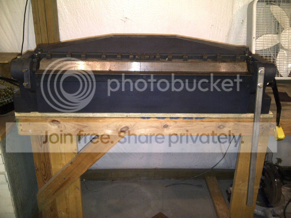

Watch Craigslist. I picked up a sweet pan/box brake. Not sure what brand it is (it's not marked) but it's very high quality and appears be domestic production. All surface ground fingers, high quality castings. It's at least 400 lbs. Heck, the eccentric shaft is 2" in diameter. Anyway, it appears to be new/old stock. A bit of surface rust but doesn't appear to have ever been used. Got it for $500 but it looks like at least a $1500 unit.
I also wanted a shear but since they are so limited in what they can do vs. the cost I decided that my plasma cutter plus a straightedge clamped to the sheet works good enough.
