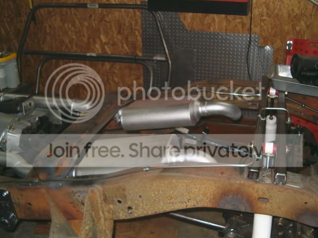

would this be a bad idea do to burning through the metal lines? of course fuel line drained
Only if the line is close enough to the weld area to be of concern. I've boxed frames with them inside to no ill effect of course more attention needs to be payed.
I ran all mine on the inboard side of the frame, external of the boxing. I have an area of concern now I will need to protect the lines from exhaust manifold heat right next to the starter.
I'll figure it out.
I hung my fuel line (the only one inside the box) with clamps to keep it away from direct contact with the frame....
good to hear i can work around them. i wasnt really lookin fwd to plumbing it all. thats pretty cleantho, zimmer.
